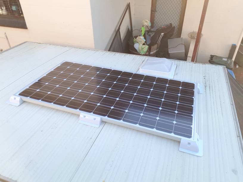

    200w pannel on the van.
    Makes the roof look tiny

    Did you glue the supports on westy or are they screwed into the roof ?

    Glued using sika 291 marine grade adhisive..
    And moubts screwed to pannel
    That pic is it just sitting there..

    Wise move mate , there is a special sikaflex for that , bloody expensive at $30 per tube and the stuff is a gun breaker trying to get it out .
    I have maybe four of the corner brackets left unused from when I did the caravan , the supports only really work on a flat surface .

    Yea this is about $24 a tube from bunnings..
    But father inlaws is now been on for 3 years and going well..
    And yea bloody thick!!
