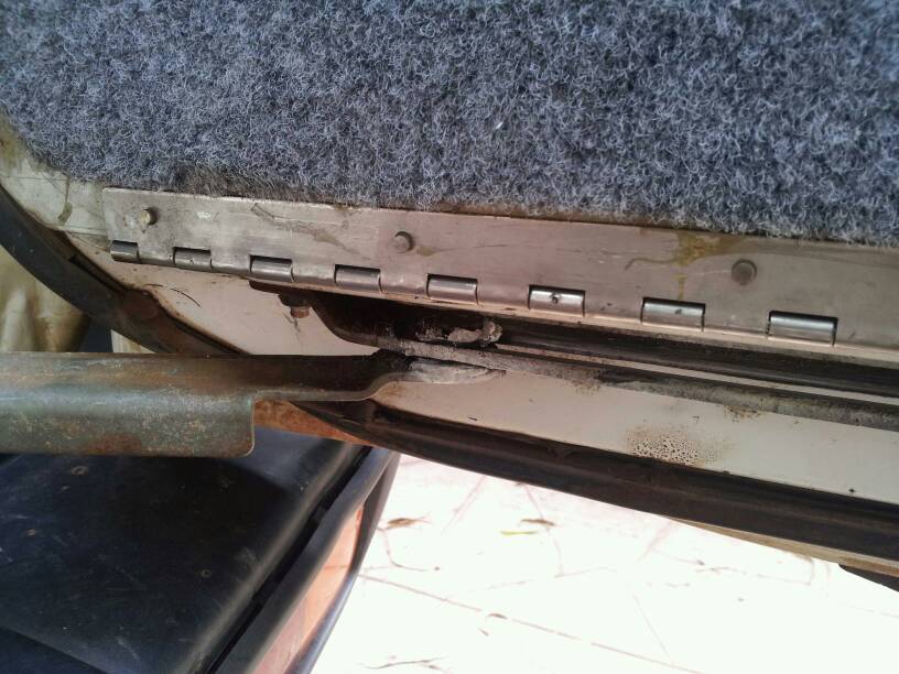

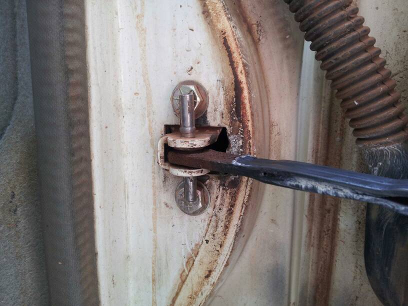

    You aren't by any chance suffering from a broken spot weld (usually a crunch when it shuts) this will need some holes and bolts like this :
    You can also see the lithium grease on the dampening arm. It wouldn't hurt to give the locking arm below a hit with the grease too as pictured here:
    Also the other end of it.
