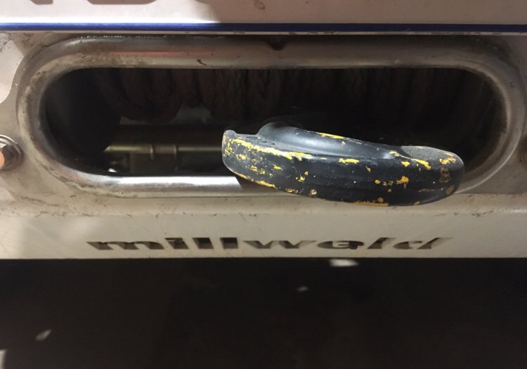

@MudRunnerTD kindly guided me to Phil at the 4wdShed [emoji106][emoji106][emoji106]
http://www.nissanpatrol.com.au/forum...019/09/131.jpg
Depending on usage Dave mate, might be advisable to keep fairlead’s replaceablish if that’s such a half dwucken word?
Looking good mate. Nice work. With the grill switches, I run them on the passenger side as chances are it is the Navi operating them most of the time and saves them standing right in front of you and obstructing your view. You will find most comp cars run them on the left side too to be honest. They will work fine where they are though.
Can highly recommend adding an LED marker light either hanging under the winch motor or the back of the bar facing back to the winch drum makes seeing the winch at night bloody awesome. I wired it through the winch isolator so it is a double check when I want to make sure do have power to the winch.
Mine did not come with this little clip. It IS REQUIRED! It make something that does this job. If you don't have it the line with spin uncontrollable and self destruct first time. 8 fashioned up something and used zip ties to hold it in position. Doesn't need much but it needs something
Also note, when using your air freespool . You need the navi to give the rope a tug after you re-engage the rope to lock it back in before you press line in.
Thanks for the advice, might see how I go with the switches before moving them.
Hey Darren, I have been thinking about these switches and their location for a couple of days and what troubles me is the location is within what is called the 'line of fire'. The recoil direction is going to head straight back to the anchor point, so understanding the drivers field of view issue, but moving them to the passenger side still retains the hazard. For this reason, I have a cable pendent control with 6m of lead. I know its not as self contained or convenient, but it sure removes the winch operator from the immediate recoil zone, regardless of whether a winch blanket is in use or not. I further understand its impossible to monitor the cable or rope wrap from 6 m away, behind a bar, and this does require frequent 'stop and check actions'. Just a comment, and appreciate they may be in use in comp trucks, but does not mean the risk is reduced or removed. For me, I would not have the switches mounted where they are so close to the winch. Comments welcome of course.
I believe it’s more for just ease of spool housekeeping Phil mate. All the heavy work is usually done through in cab switches.
