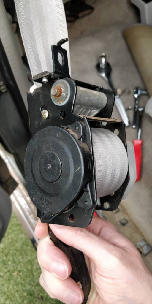

Everyone can manage getting access to the tensioner, so I'll skip to the good bit.
This is in my GU III 2004.

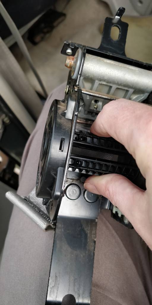

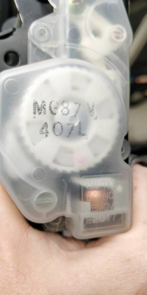

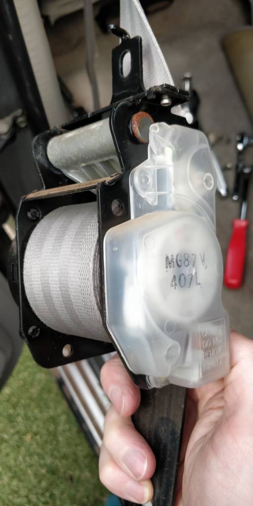

You can see plastic covers on both sides with 'do not remove' on them. Pay attention to that. Leave them on there.
http://www.nissanpatrol.com.au/forum...019/05/330.jpghttp://www.nissanpatrol.com.au/forum...019/05/331.jpg

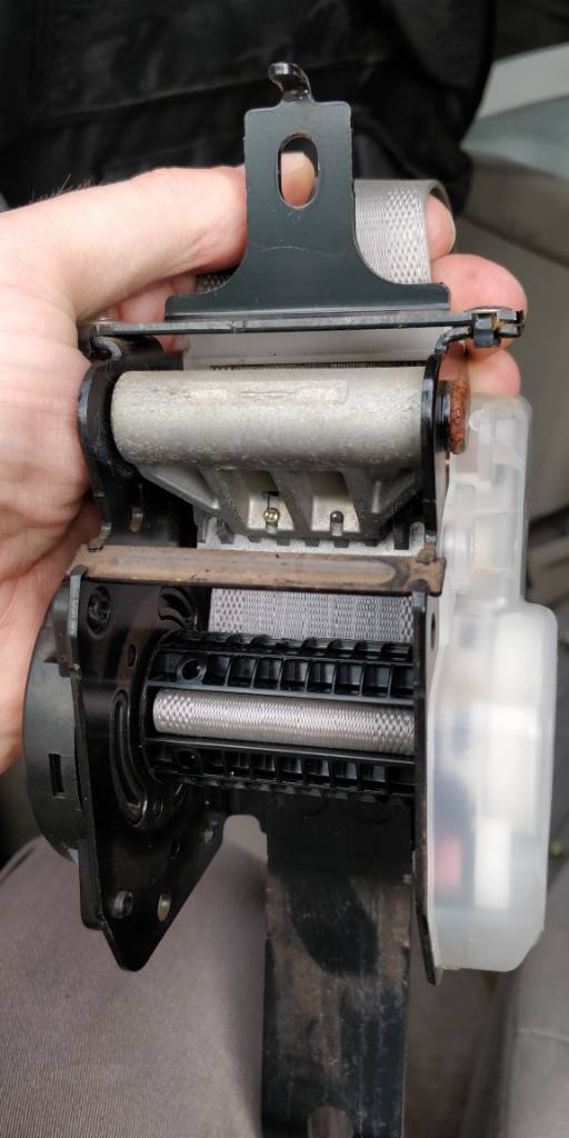

And here is a detail of the mechanism with tilt lock (the copper part). You'll need to hold the tensioner vertically to release the belt.
http://www.nissanpatrol.com.au/forum...019/05/332.jpg

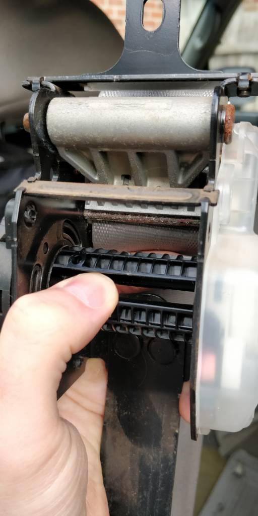

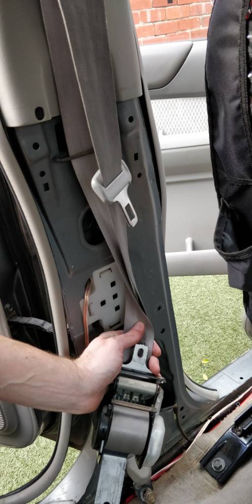

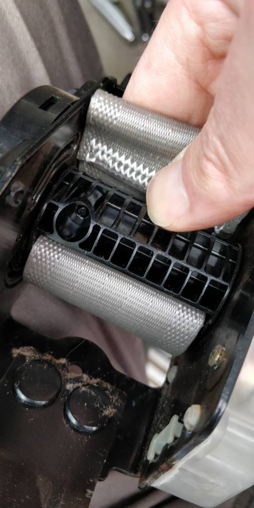

Pull out all the belt length until you see the plastic spool.
http://www.nissanpatrol.com.au/forum...019/05/333.jpg

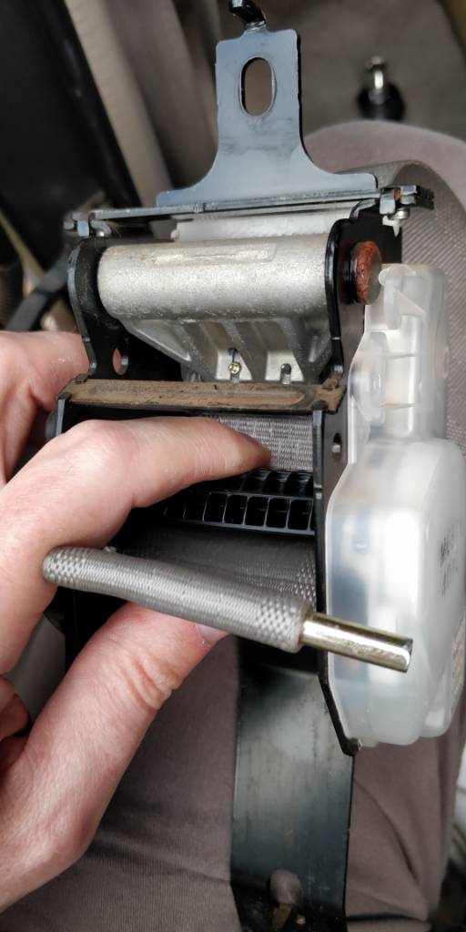

You'll need to hook the belt end and pull it from the plastic spool. Loosen off a bit of tension from the back so it's not held in with any pressure.
I used a scribe with a 90° hooked end.http://www.nissanpatrol.com.au/forum...019/05/334.jpg

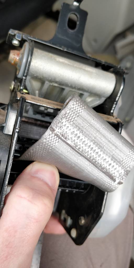

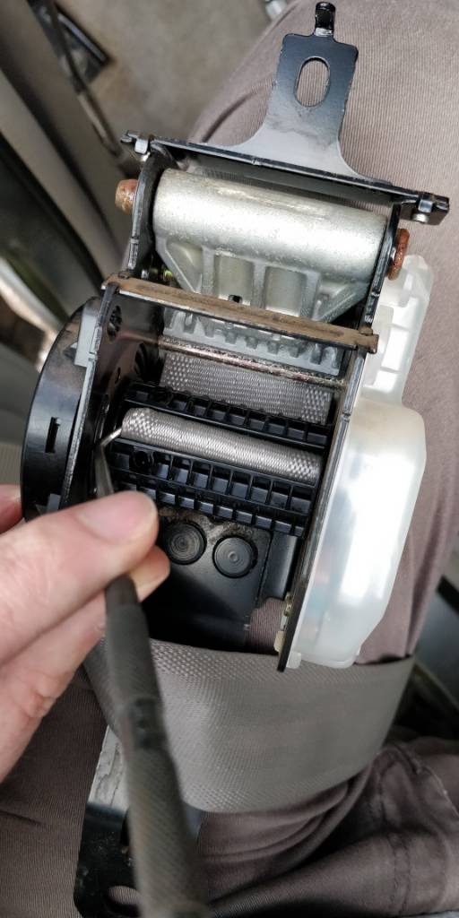

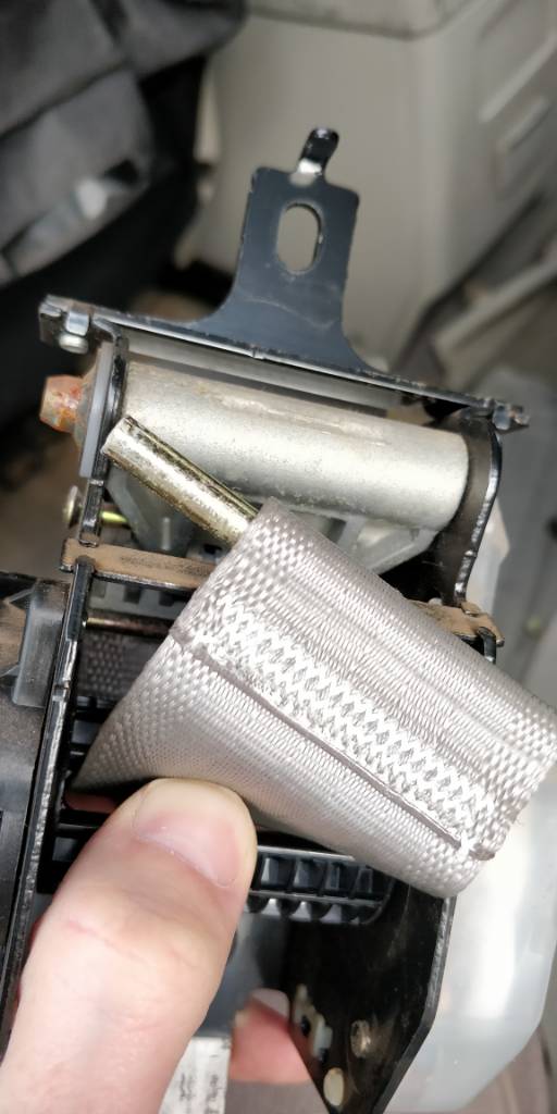

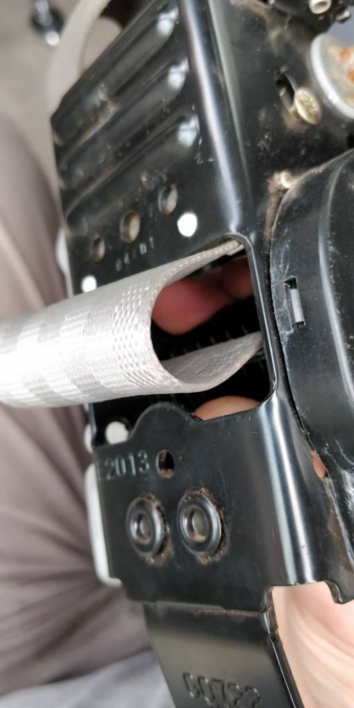

Pull it out and push the little pin out of the loop.
http://www.nissanpatrol.com.au/forum...019/05/335.jpghttp://www.nissanpatrol.com.au/forum...019/05/336.jpg

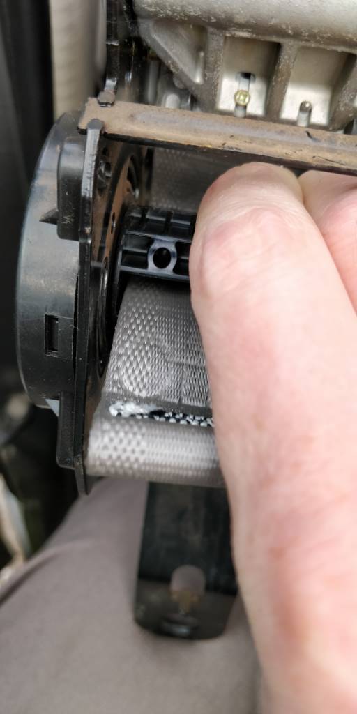

Before you remove the strap, take note of which way it feeds though. The slits are slightly different thicknesses, but you can see a small hole at the loop end and a big hole at the back where the belt feeds into the plastic spool.
http://www.nissanpatrol.com.au/forum...019/05/337.jpghttp://www.nissanpatrol.com.au/forum...019/05/338.jpg

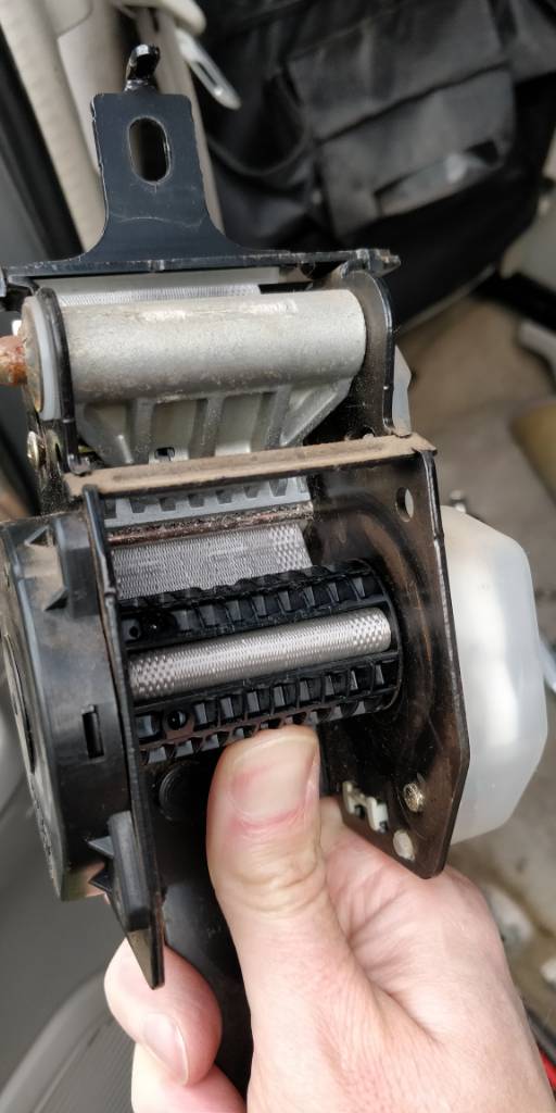

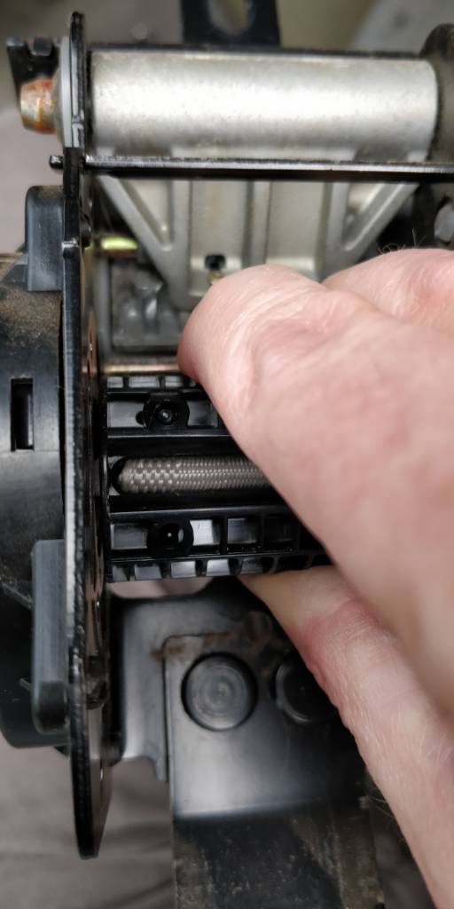

Pull the belt out and keep a tight grip on the spool from the front and back by pinching your fingers into the slots. It's not hard to keep hold of. Just like a fully extended tape measure.
http://www.nissanpatrol.com.au/forum...019/05/339.jpghttp://www.nissanpatrol.com.au/forum...019/05/340.jpg
Use two hands to wind the spool against the tension. Just turning it with your thumbs while also keeping fingers on it from the back too. For my driver's side I think I wound about 6 - 8 full rotations, for the passenger side I only did 4.

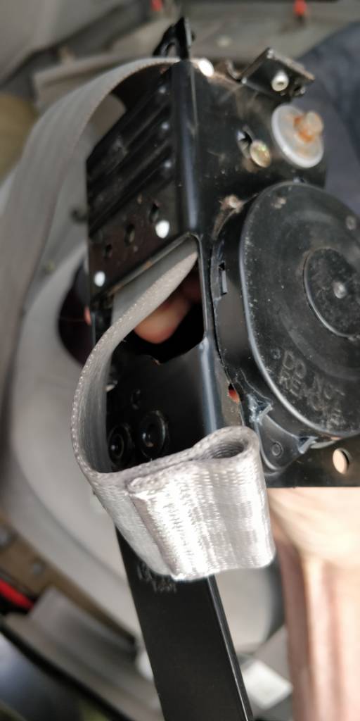

Line up the spool and feed the belt loop back through the side of the spool you took notice of earlier ;)
http://www.nissanpatrol.com.au/forum...019/05/342.jpghttp://www.nissanpatrol.com.au/forum...019/05/343.jpg
Push it through and reinstall the pin.
http://www.nissanpatrol.com.au/forum...019/05/344.jpghttp://www.nissanpatrol.com.au/forum...019/05/345.jpg
Pull the belt loop back into place and let it retract slowly.
