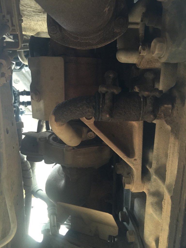

Hey mate no the turbo itself was the issue but I had to spend a shipload of time proving it was the turbo and not my set up.
You've got the factory oil drain though yeah?
Yeah mate identical to Darren's.
http://www.nissanpatrol.com.au/forum...018/11/178.jpg
Ok cool your drain will be fine mate, just make sure it's a nice smooth curve direct path to it and it'll be fine.

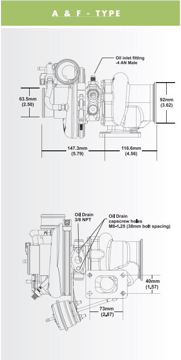

Image below for oil
Try and find our engine fittings for these or even take your old lines into pirtek and they'll sort you out or someone else can shimmy in.
http://www.nissanpatrol.com.au/forum...018/11/182.jpg
