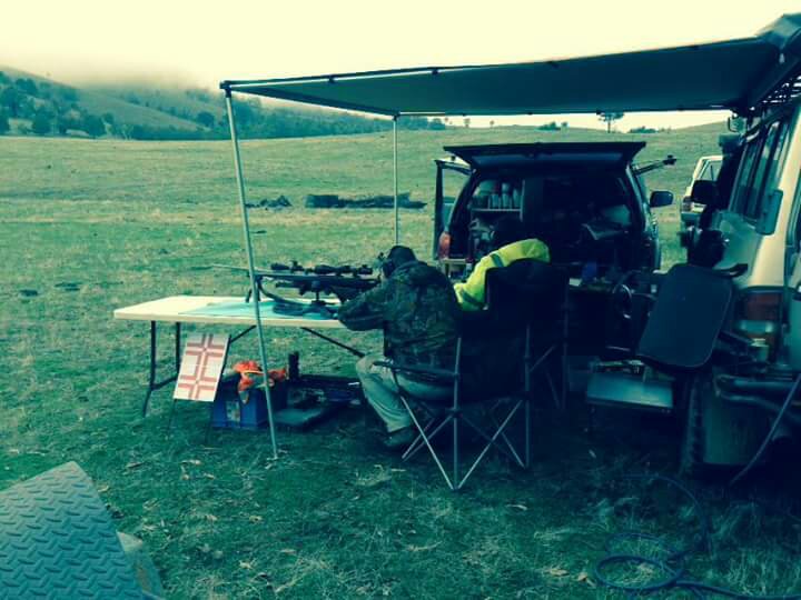

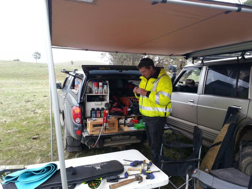

I have fitted a pair of pull out awnings to my roofrack. I have gone a 2.4m long side awning and a 1.2m long rear awning. I chose ARB for both and got a good deal on the pair from the 4WD Show.
I like the rear awning for making lunch in the sun or the snow or rain. Works great. also have used it to provide shade to the fridge when parked up for a long time at camp too.
