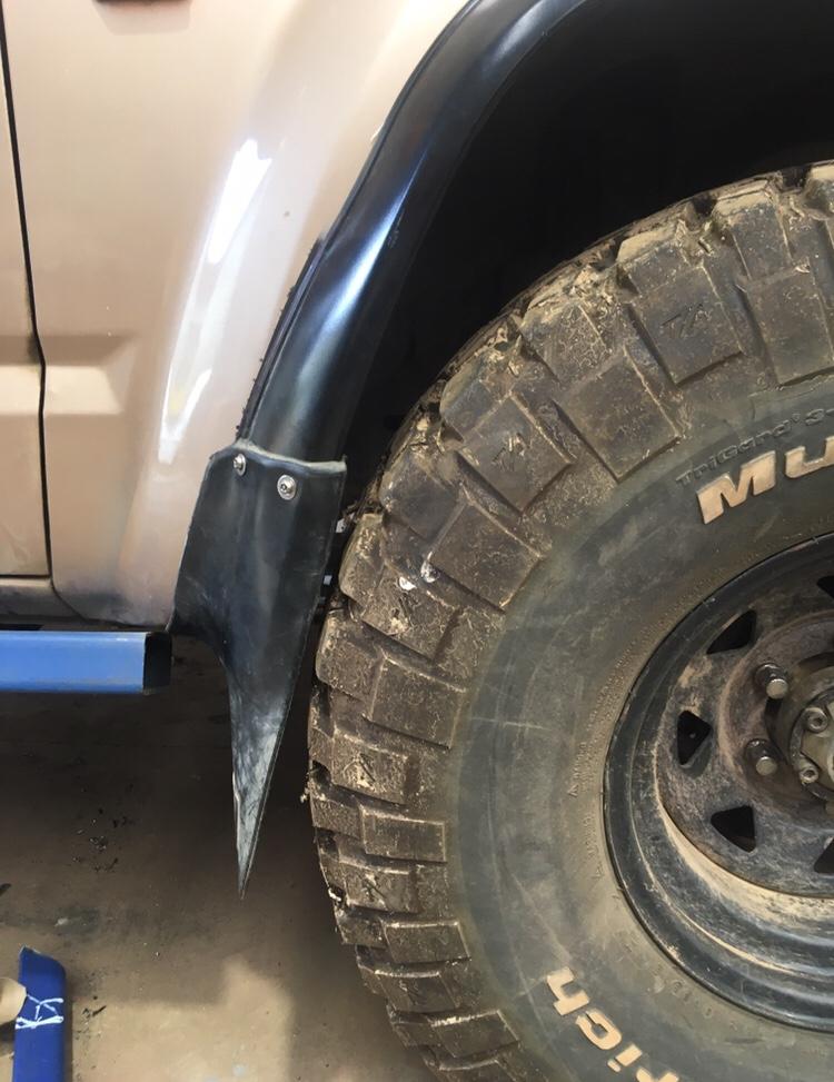

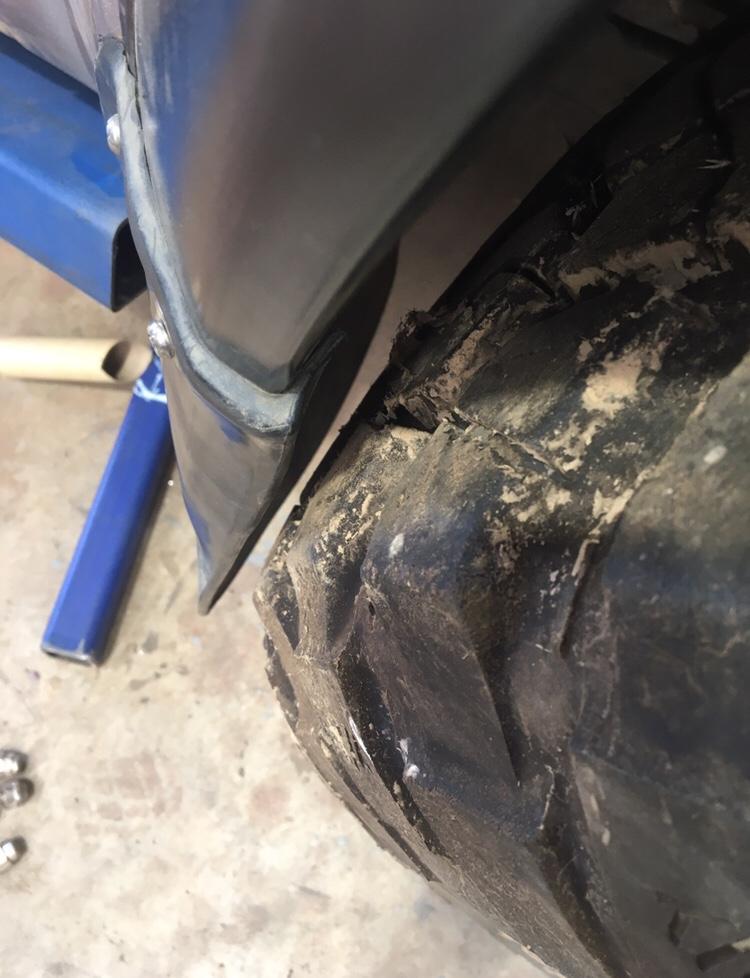

FWIW: Finally swapped the GU’s 35’s across to the little GQ now with 40mm reduced rear guard butchering I had done earlier:
http://www.nissanpatrol.com.au/forum...021/02/103.jpg
Externally it still looks tight highway old height and pre 2” mild lift work but trying my best to keep it looking OEM tame as best as possible [emoji23]
http://www.nissanpatrol.com.au/forum...021/02/104.jpg
Radius arms forward shifting castor correction work thankfully starts next week with extended bump stops holding up 3” down travel shocks so fingers crossed I won’t hear that dreaded full lock downhill ‘dickada dickada dickada’ crap [emoji90][emoji23][emoji106][emoji106]
maybe drop ya tyre pressures winnie???

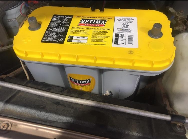

Took a bit of a gamble yesterday purchasing a D31A for the GQ’s main battery as I’ve only ever been able to fit slightly smaller D27’s in GU’s main trays length/width wise previously believed.
Thankfully it did fit last night tested with only a slight position twist required which was made possible by the offset spiral core design:
http://www.nissanpatrol.com.au/forum...021/02/108.jpg

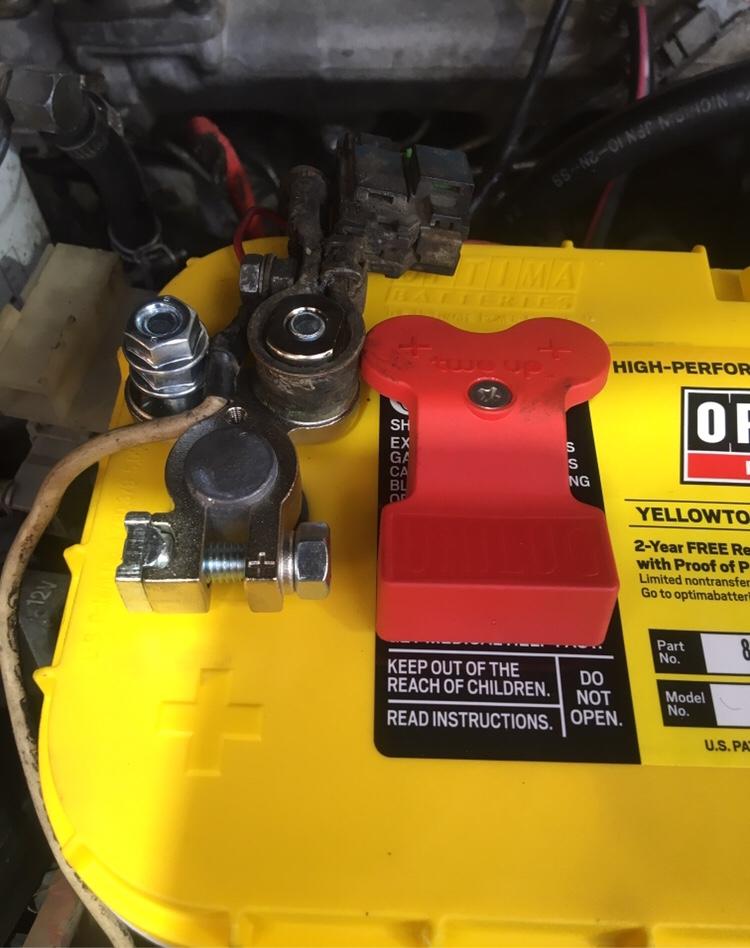

Next overlooked problems found were the D31A terminal posts are all mounted central unlike the D27 variants with standard off-sets & the taller battery height brought the terminals too close for comfort to the closed steel bonnet heat lining.
Problem easily solved thanks to ‘Baxters’ passing through there today:
http://www.nissanpatrol.com.au/forum...021/02/109.jpg
‘Unilug’ is a brilliant Aussie design just found and are so happy I don’t have to modify the OEM engine wires longer to reach too [emoji120][emoji106][emoji736]
http://www.nissanpatrol.com.au/forum...021/02/110.jpg
Wow! I like those Unilugs.
