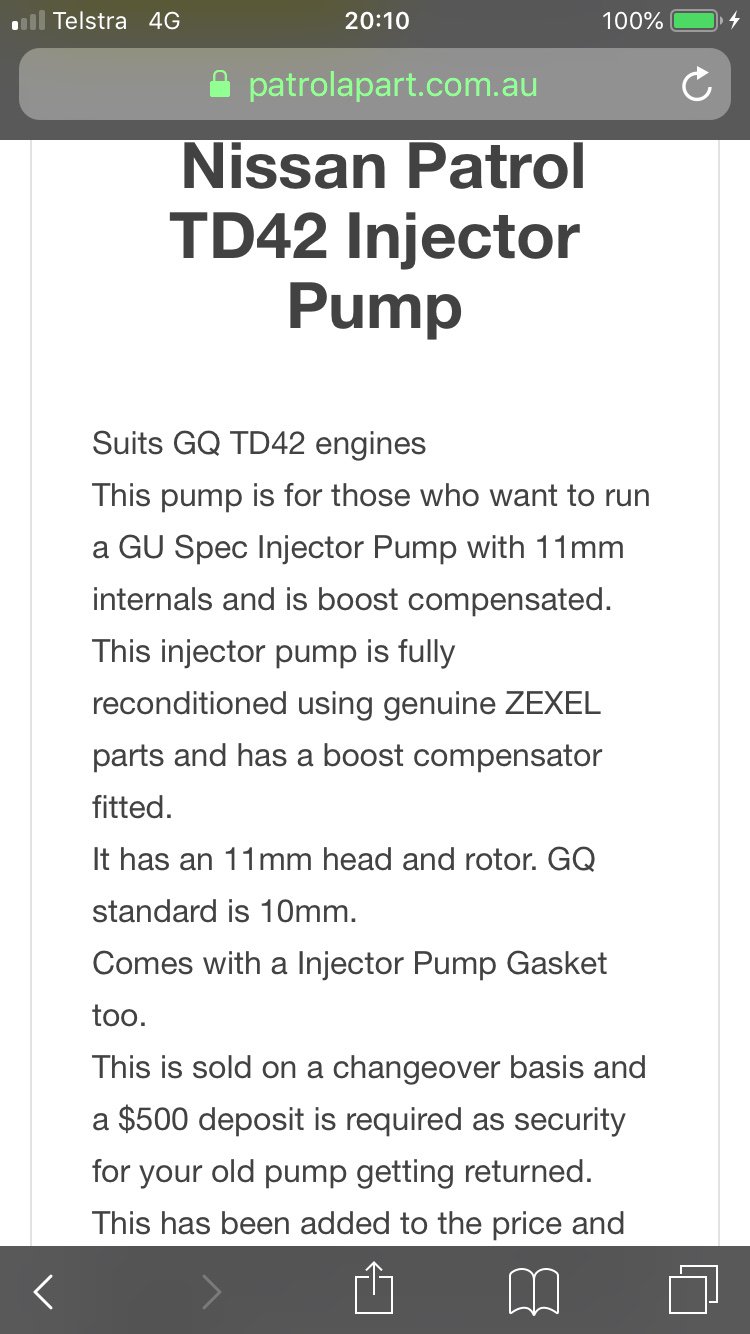

More McGoogling just now just found a possible telltale that 11mm is stock for all GU’s they’ve apparently worded for GQTD42 older goldies upgrades?
http://www.nissanpatrol.com.au/forum...2019/07/61.jpg
Probably best just to get my arse into gear and intercooler the old bus ASAP :-)
