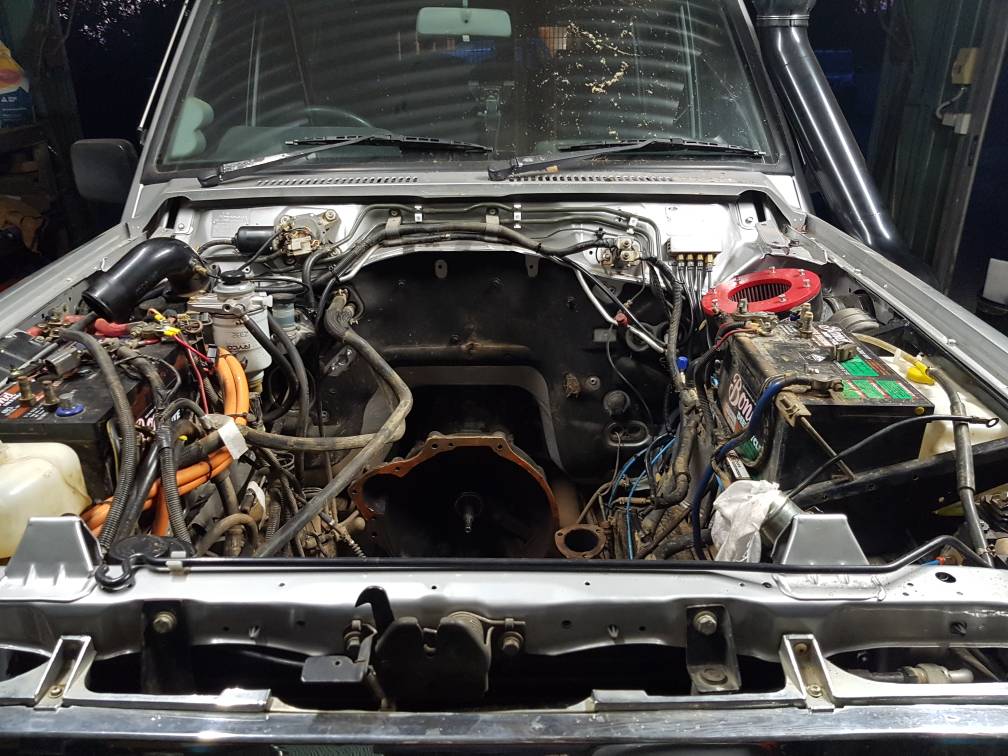

Oh yeah so. . . Had been meaning to give a bit of an update with the old thing but been kinda flat chat with things lately it's been crazy . .
So I ended up getting a little bit carried away with the motor and after pulling the head and and doing some cleaning of the block found a bit of carbon scoring in the bores (only a couple). Did a leak down test using some 2 stroke held fluid pretty well but one thing led to another and pulled the motor down for a strip and rebuild. Taken a while but should be ready to pick up tomorrow hopefully. Think I figured that while I'm here do the head, then thought half way there to do the bottom end too, plus kays were getting towards 400 and keen on doing some big trips in the future so will be good peace of mind knowing its all fresh. Keen as to get it going, has been balanced so hopefully is a bit smoother than before.
Everything is ready to go back together now, had to repair a couple of threads in the bell housing from when my mate just smashed a couple of bolts in with the rattle gun. (grrrrrrr )
Anyway should be up & running by easter then get some kays on it before a tune hang'n to get back into it TBH.
[emoji53] http://www.nissanpatrol.com.au/forum...018/03/214.jpg
