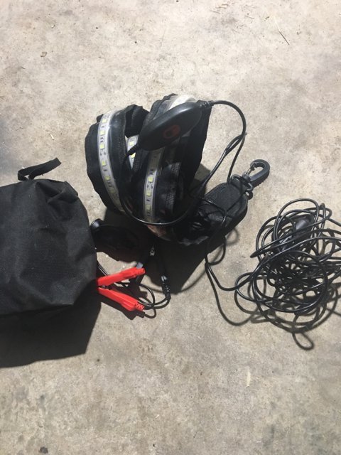

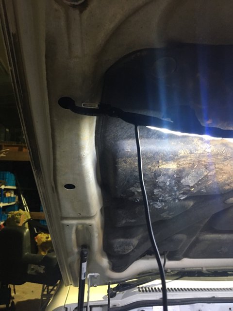

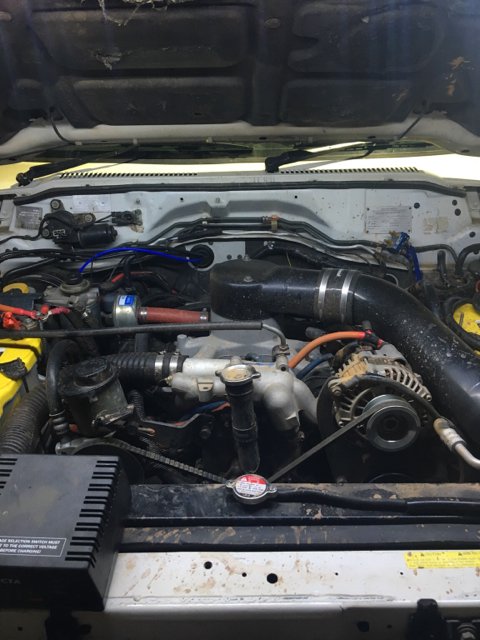

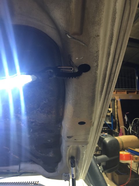

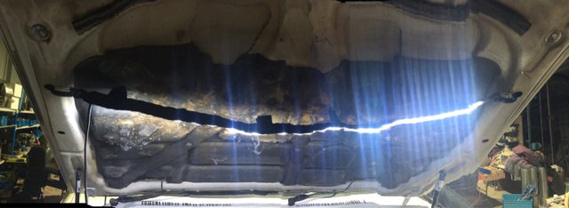

No doubt as usual the wrong thread to post but found a great use for the LED light strip that came free with the Titan drawers years ago:
http://www.nissanpatrol.com.au/forum...017/08/274.jpg Fits the GU bonnet holes amazingly perfect for a great work light :-) http://www.nissanpatrol.com.au/forum...017/08/275.jpghttp://www.nissanpatrol.com.au/forum...017/08/276.jpghttp://www.nissanpatrol.com.au/forum...017/08/277.jpg Little bag came with a ciggy plug to aligator type battery nearest adaptor too. http://www.nissanpatrol.com.au/forum...017/08/278.jpg How long it will last who knows but has a thumb touch dimmer switch thingo too :-)
Have the same light and yes would be good for that .
Same light here too, great to hang vertically off the awning to help one find their way back to camp when returning from a night fish. Just repaired mine as the +ve wire broke away from led conductor strip-just removed the plastic boot weather protector & scrapped away the varnish off the led copper conductor strips, resoldered wire (polarity stencilled on strips) and it goes again.
