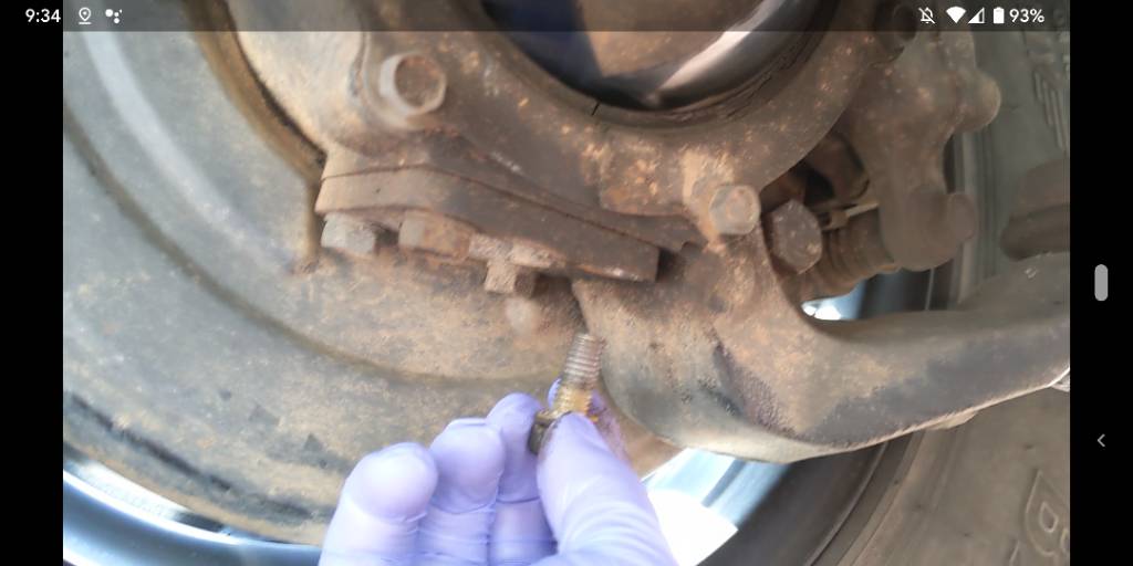

140k.
And apart from tightening the bearings as per this thread, nothing else had been touched or regreased, like , ever.
Drizabone both sides .
I guess , most likely bit of water got through auto hubs ... So bead of silicone a trick as muddy suggested ?
