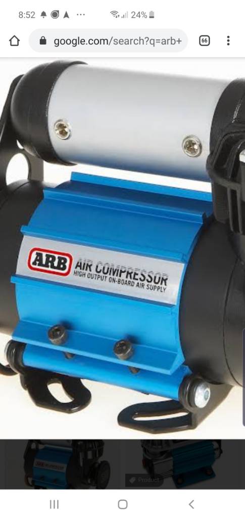

I mentioned "ports" earlier, this means the hole that you thread the switch to into. If it was screwed into one ofnthey holes in the compressor then swap to a different port of the compressor. There are a few ports on the ARB compressors .
You could unscrew the gauge and fit the pressure switch there to test too.

Try the switch in a compressor port and see if there is any difference .

The cylinder on thr side of the ARB Compressor is actually a little tank. The Alan key nuts in the side and ends are spare ports. Any one will do mate.
Hope this helps in some way.
http://www.nissanpatrol.com.au/forum...019/10/142.jpg
Those 2 allen keys are ports that you will be able to screw you switch into.

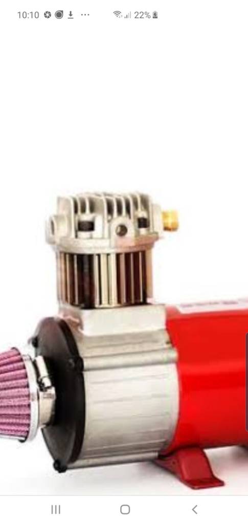

My compressor is a Boss PX07, doesn't have any ports in it for a switch. Switch goes into receiver tank.

Ok. The ports are out of the head. There will be more than 1. Where your hose is coming out is 1, look for a blanked off second one. In the pic below it has 3 I can see bit I expect there is probably 4. Others on google showed no port on 1 face but multiple options certainly.

Thanks Darren. It does look like those are ports, but they are just part of the casting that are unused. Not drilled or threaded, only useable port is the one the hose comes out of. Unlike some compressors this one requires a one way valve in the hose between compressor & tank, so fitting a pressure switch into the cylinder head even if it were possible would probably not regulate the tank pressure very well, if at all.
