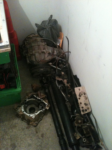

Been a while so I thought I should update on progress with automatic gearbox rebuild. Following my last post I had the box out and on the driveway which was good. On to the scary part of taking it apart and seeing what was knackered.
First job was removal of the transfer:
http://www.nissanpatrol.com.au/forum...2012/08/13.jpg
Following that disassembly is pretty straightforward. Very little is pressed together so you basically unbolt the bellhousing and oil pump, pull out the oil pump and the gear assemblies all come out in sections. The worst job is without doubt getting some of the snap rings out. I was tight and wouldn't buy decent snap ring pliers so swore a lot at it and grazed my knuckles a few times. I massively suggest getting the proper pliers unless you want to look like a member of fight club!

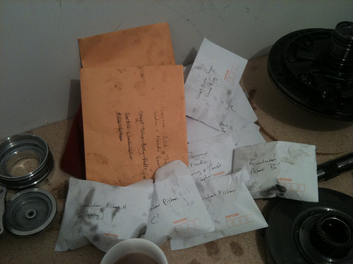

The workshop manual is nice and easy to follow. There are lots of thrust bearings and thrust washers so as these came out i bagged and labelled them ready for reassembly following inspection for defects:
http://www.nissanpatrol.com.au/forum...2012/08/14.jpg

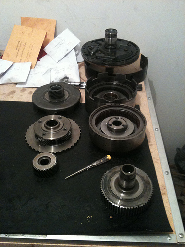

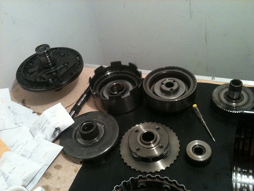

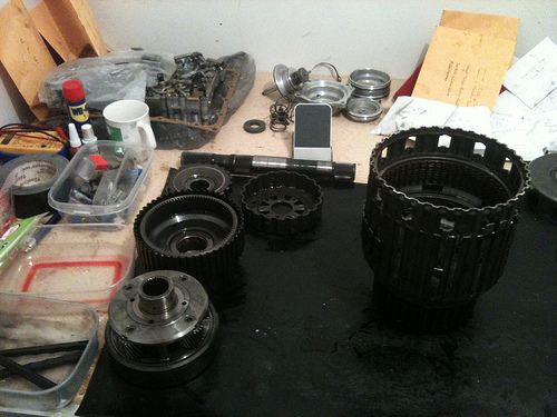

What you are left with is a pile of cogs, gears and clutches a bit like this:
http://www.nissanpatrol.com.au/forum...2012/08/15.jpg
http://www.nissanpatrol.com.au/forum...2012/08/16.jpg
http://www.nissanpatrol.com.au/forum...2012/08/17.jpg

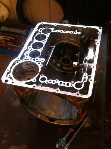

Following removal of all the guts you are left with this:
http://www.nissanpatrol.com.au/forum...2012/08/18.jpg
So thats disassembly. Next part was inspecting the clutch packs and band for wear, which I will cover in my next post.

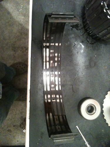

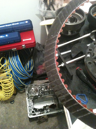

First off the band:
http://www.nissanpatrol.com.au/forum...2012/08/19.jpg
As you can see the brake band was completely stuffed. This should have been covered in friction material but instead all that was left was the metal part of the band. This had worn some deep scores in the surface of the reverse clutch housing as well which was frustrating. A slab of beer for the machinist at work and that was sorted out though.

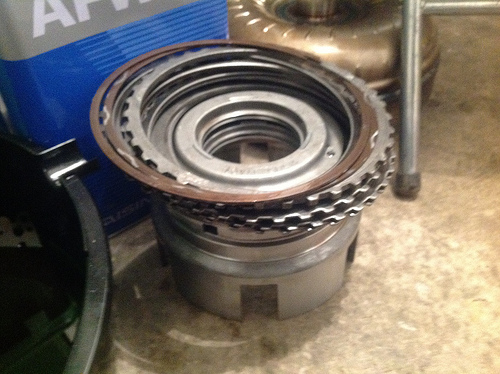

Next the clutch packs. First off the snap rings retaining the clutch packs are removed and then the clutch and drive plates can be removed. This is one of the many clutch packs here:
http://www.nissanpatrol.com.au/forum...2012/08/20.jpg

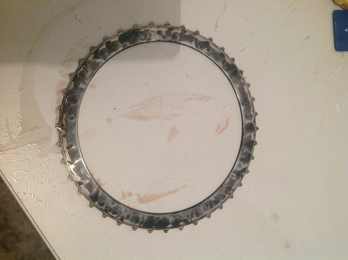

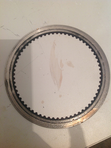

The clutch plates and drive plates were inspected for wear. I was replacing all of the frictions (clutch plates) anyway but the steel drive plates needed to be checked for warping caused by overheating. The reverse clutch turned out to be hanging on by a thread with two of the three clutch plates worn to metal like this:
http://www.nissanpatrol.com.au/forum...2012/08/21.jpg
This is one that wasn't badly worn to give some perspective:
http://www.nissanpatrol.com.au/forum...2012/08/22.jpg
A couple of the drive plates were also warped so these were replaced as well:
http://www.nissanpatrol.com.au/forum...2012/08/23.jpg

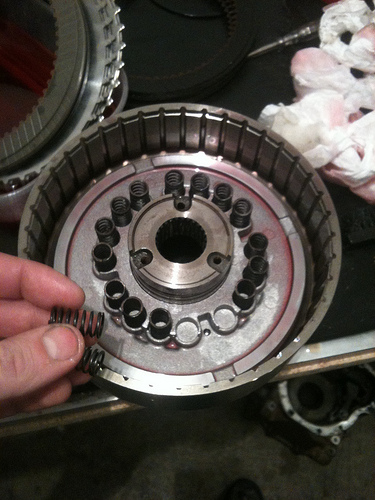

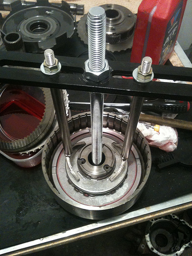

So this basically told me why I had no 2nd or 4th and reverse was a bit dodgy (took a while to engage)! At the same time as replacing the friction pack and the odd drive plate a full seal kit was also put in. To do this a clutch spring compressor was required to remove the clutch pistons from each clutch assembly. I got an Am-Pro that cost $50 I started to take a look at the clutch packs. You use the spring compressor a bit like this:
http://www.nissanpatrol.com.au/forum...2012/08/24.jpg
By compressing the retaining plate towards the body of the clutch the snap ring stopping the clutch from falling apart can be removed. The spring compressor is then released leaving the springs underneath:
http://www.nissanpatrol.com.au/forum...2012/08/25.jpg
