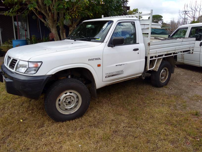

The ute itself is 16 years old, has been in the family since it was new and has done just 70,000 km. The only modifications it has had in that time is a towbar, a hydraulic tipper unit based on a steel tray and a spotlight wiring kit (but no spotlights). A TJM bullbar with a winch attachment (to carry an old Ramsey REP 8000) was purchased but it was never installed.
It has lived all its life on the NSW Central Coast where it provided property support duty for my parents and as a second vehicle. Usage was infrequent but intense. The property is now gone and it has come to us on the NSW Central Western Slopes and Plains to be our property ute.

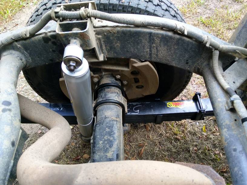

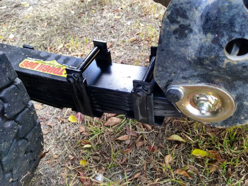

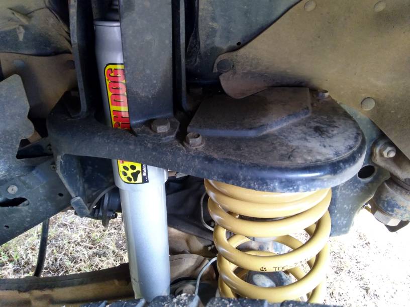

So the bullet got bitten. And 4 Way got the coin. 41 mm Tough Dog foam cell shocks, HD coil springs (that appear to be Kings), 11 leaf rear spring packs (the OEs are 8) with greasable pins and shackles, U-bolts and a return to centre steering damper. All up just shy of $2400...
The latter is like a coil over shock for your steering - it might be voodoo lipstick on a pig but having had one in the past that cured a wayward Defender I figured that there might be something to a bit of spring bling.
Unfortunately, my shed is non-existent at the moment and my bigger tools are mostly tucked away in storage...so the local shop got this job. 4.5 hours and $700 later, all done.

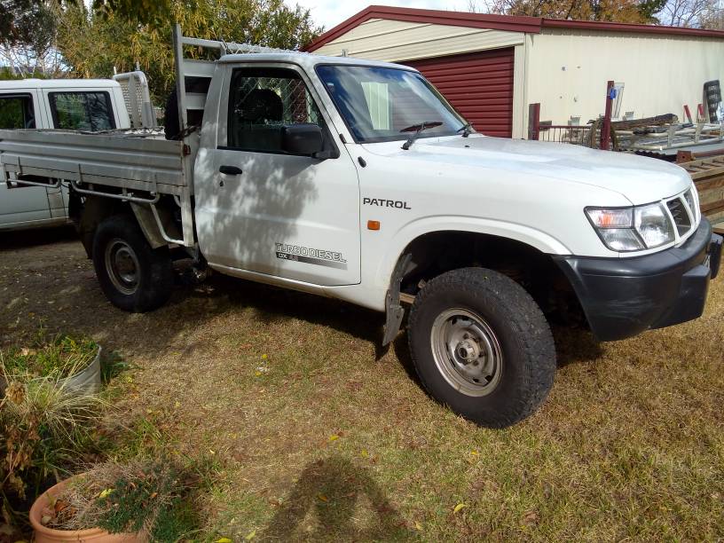

The front end came up just shy of 50 mm. As expected, the back end came up more but even I was surprised how far...90 mm! So the original leafs were stuffed!
That then made me worried how it would drive empty. However, it sat there looking quite normal so maybe it was okay. And it has turned out to be okay. No jiggles, no skittishness, just the sort of behaviour you'd expect from a properly sorted working vehicle. It's no sporty handler but it handles just fine. The new steering damper is a treat too since it now easily goes where it's pointed and stays there to boot.
