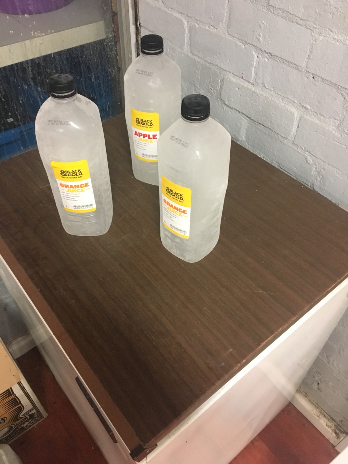

G’day Toddstar mate, unsure of that model and goods/temps you may require to cool. Only advice I can offer is that all fridges/freezers seem to appreciate a certain goods volume within to run more efficiently. Before departure and packing goods whilst waiting for my girls I can use contained ice blocks to get our rigs systems started! http://www.nissanpatrol.com.au/forum...017/11/182.jpg $2 per 2L IGA brand rectangular juice bottles refilled and hard frozen can either stay onboard for water needs or remove once goods are ready to pack :-)
