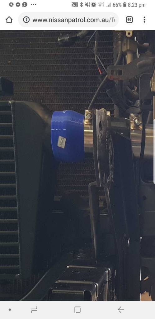

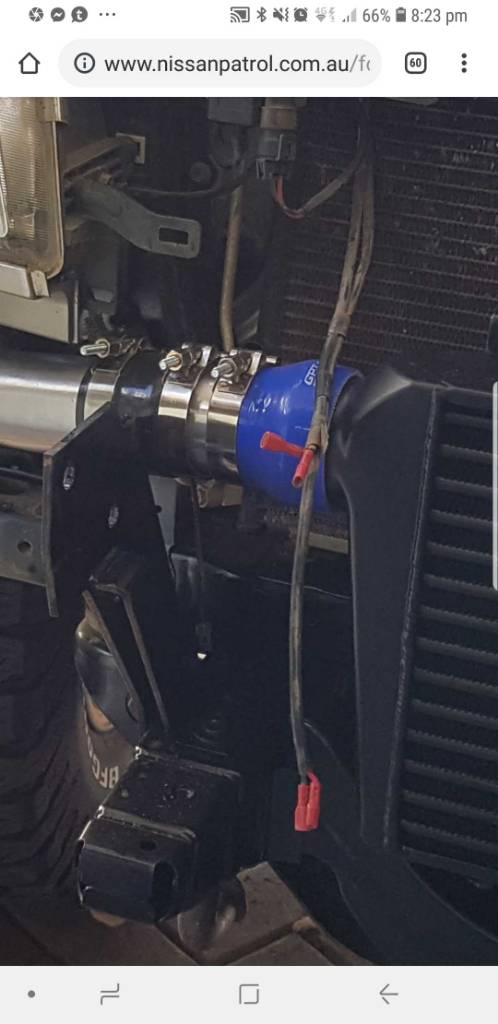

I've just ordered a 230hp 12mm fuel pump from UFI over in WA and some other bits and pieces including a planned front mount upgrade for the intercooler.
Thought I'd put the shout out and see if anyone has any advice before I start pulling bits off. Any tips and tricks particularly on removing/replacing the pump would be appreciated.
Also if anyone wants to see anything in particular from my upgrade while I'm doing it I'd be happy to follow up on here.
