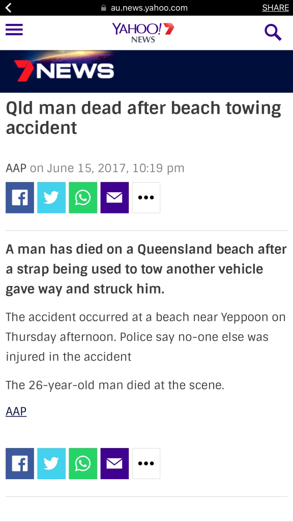

I will just leave this here
http://www.nissanpatrol.com.au/forum...017/06/157.jpg
