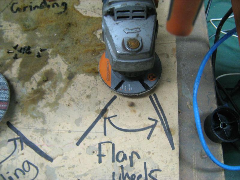

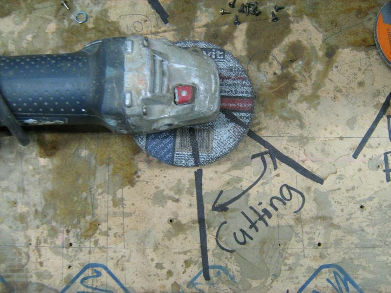

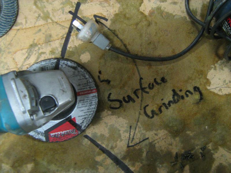

Hey and with grinders if your new to them too use my pictures as a guide and don't remove the guards like I have.
http://www.nissanpatrol.com.au/forum.../2013/07/6.jpg
http://www.nissanpatrol.com.au/forum.../2013/07/7.jpg
http://www.nissanpatrol.com.au/forum.../2013/07/8.jpg
Not sure if that makes sense ?

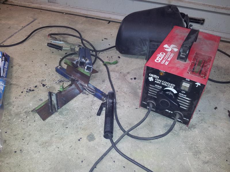

Heres my 100$ bunnings special, no where as nice and constant to weld like a inverter.
http://www.nissanpatrol.com.au/forum.../2013/07/9.jpg
Ozito brand fill a market gap........
