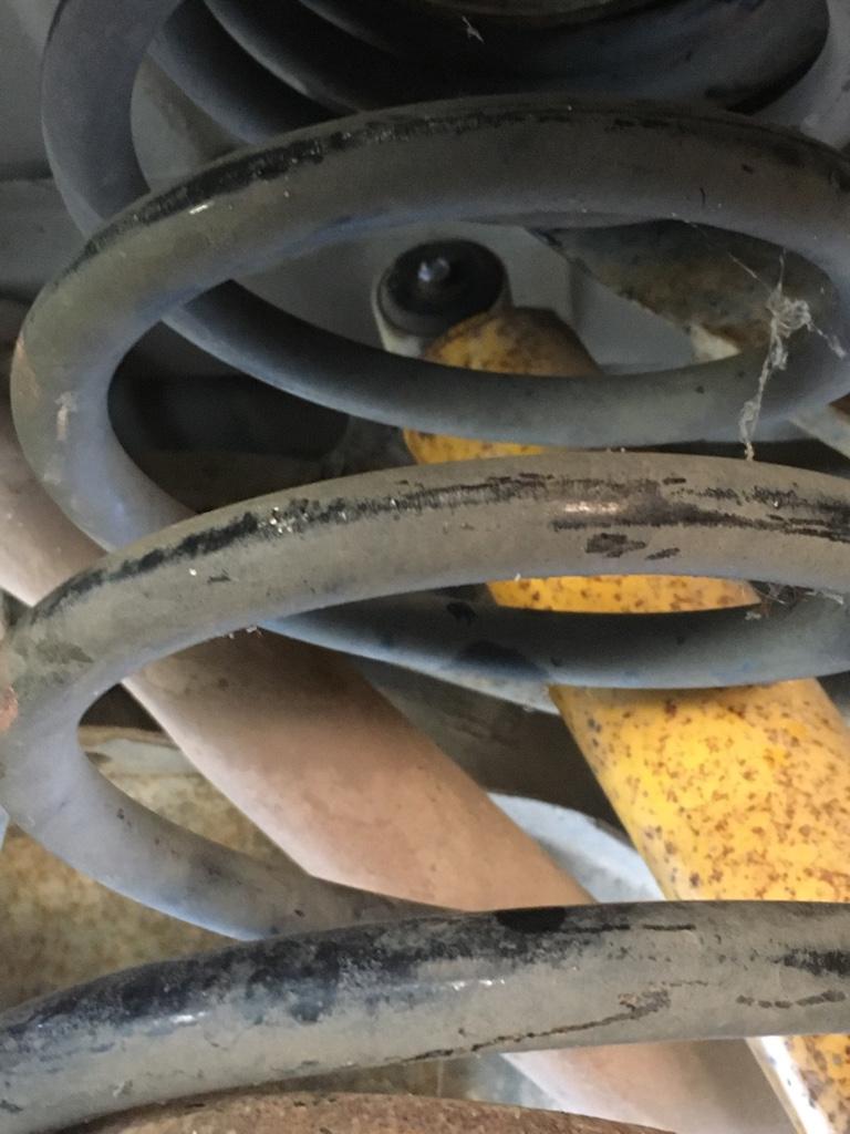

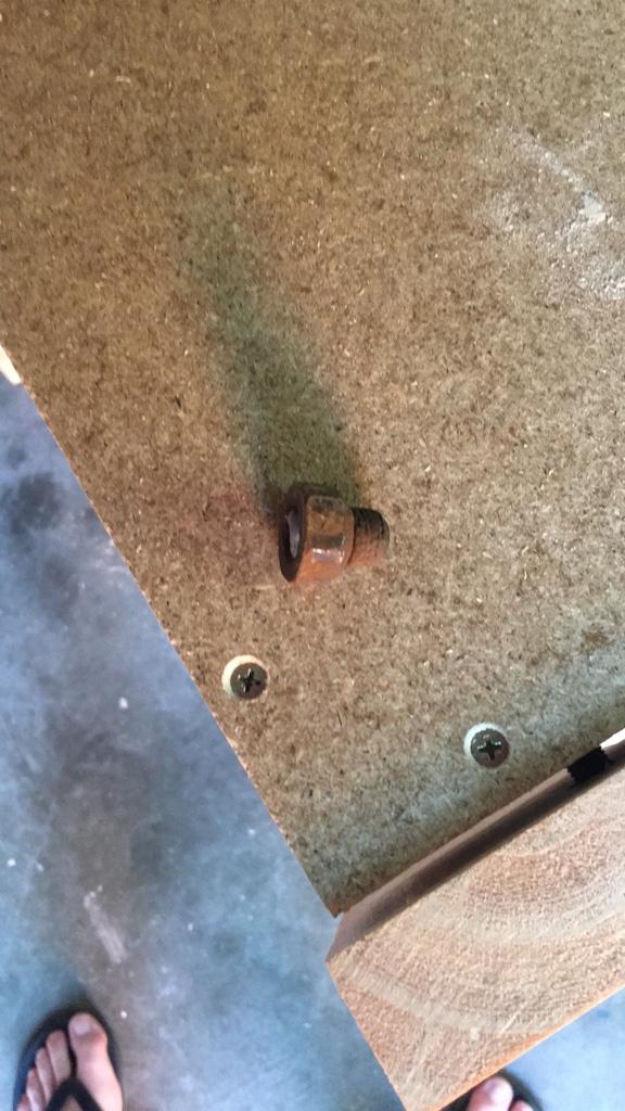

Alright, thread dig.
I have a problem with mine except mine snapped off and have been searching high and low over the internets and I'm out of ideas on how to fix mine. Pics incoming.
Anyone got any ideas? Or I'd best cut my losses and part it out?
