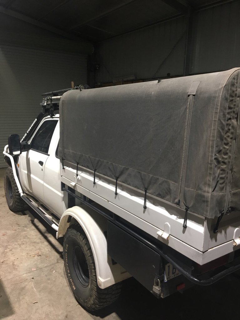

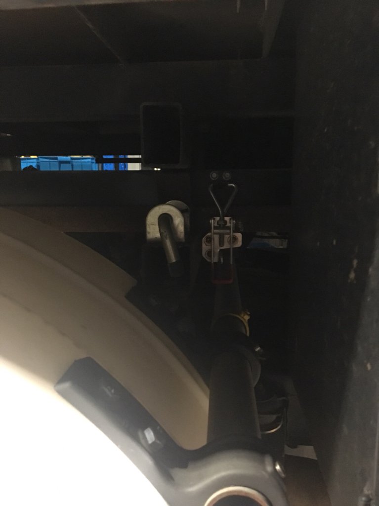

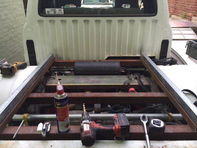

GU bastardised heavy yoots definitely need bracing just to get outa the driveway;-) http://www.nissanpatrol.com.au/forum...018/03/266.jpghttp://www.nissanpatrol.com.au/forum...018/03/267.jpghttp://www.nissanpatrol.com.au/forum...018/03/268.jpg
That plate brace for utes is awesome.
