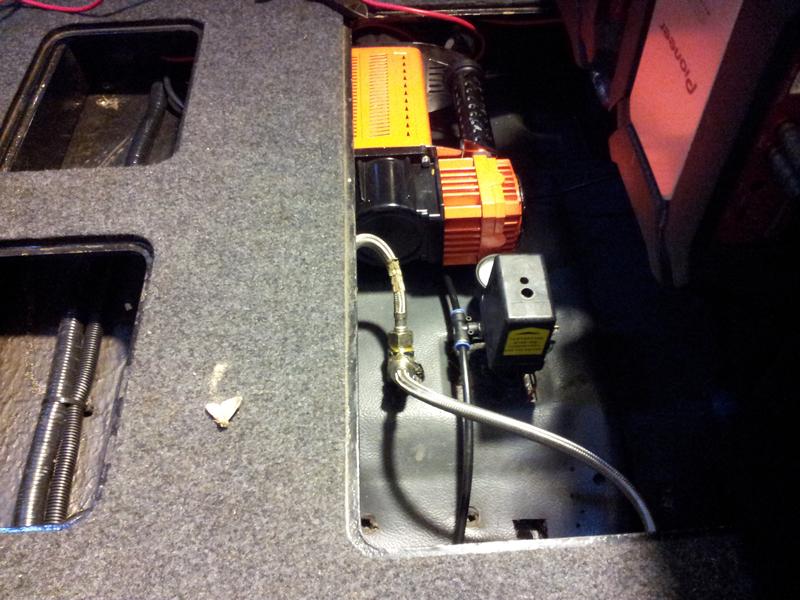

Looks can be deceiving the one in my pic is stainless 90deg and 145 psi, whats a length of that one worth line.
Gonna be a sweet set up though will be interesting to know how fast it's going to do 18- 40 psi in comparison to others. Should be a walk in the park

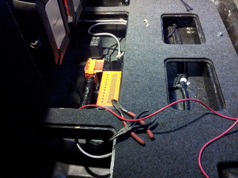

Lol we talk bout that shit later mate, I'm about two hours away from being finished. Im just bolting the compressor in atm. remove front expose the conduct with my other compressor power feeds and add new one back to battery. Drop in another relay next to the other compressors relay double the switching wires and run another power feed to battery.

Will have a switch to run either one or two compressors.
According to the maths should be 11.3cfm
Eerything is wired in and running perfect, so how are we going to test this setup?
