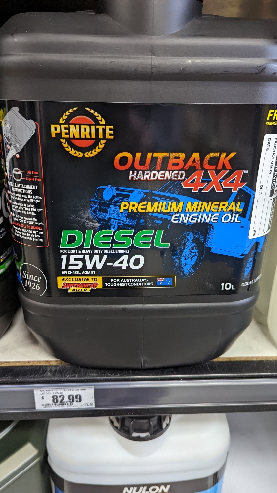

Noticed something interesting at Supercheap.
They have a 15 40 Penrite oil , apparently exclusive to them. Penrite lube guide never suggested this oil on their site . Instead it opted for the 15 50 variety.
Are they trying to upsell this HPR oil?
I could be wrong , but quick spec search well and truly meets TD needs with this Outback version. What gives ?

There is a difference & I think the 'made for Supercheap' product is lesser value, but it depends on your point of view . The 'Outback 4x4' product is a mineral oil, the HPR15 15w50 is semi synthetic. Personaly I'd rather pay just a few dollars more for the semi synthetic. I might feel differently if the 'Outback 4x4' product was more reasonably priced, on par with similar oils from other brands. I think this is a case of Supercheap trying to make some extra dollars without any real additional benefit to buyers.
Exactly Cuppa. Pricewise it's a no brainer really. And despite being mineral vs semi syn, the outback would still suit a TD I believe if it was the only oil you could get.
