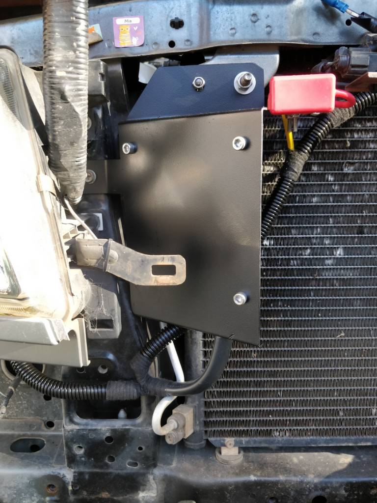

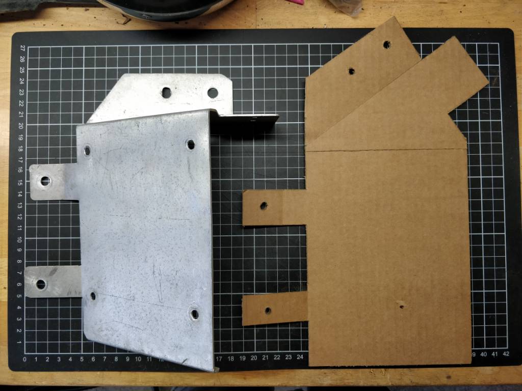

The only thing that required some modification was the bracket that holds the fuel filter, as one of the hard lines from the master cylinder fouled on it due to the extended length of the hydraulic unit.

And this is the part of the bracket we had to modify to clear the brake line:
Attachment 85208Attachment 85209
