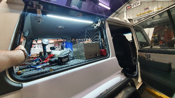

Had a productive couple of days. Had to nut out a few thing and figure out where I was going to pull power from but really bloody happy with the outcome.

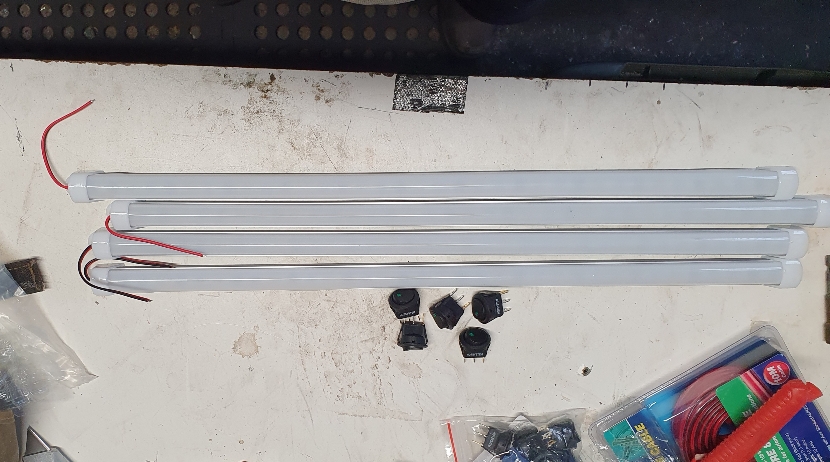

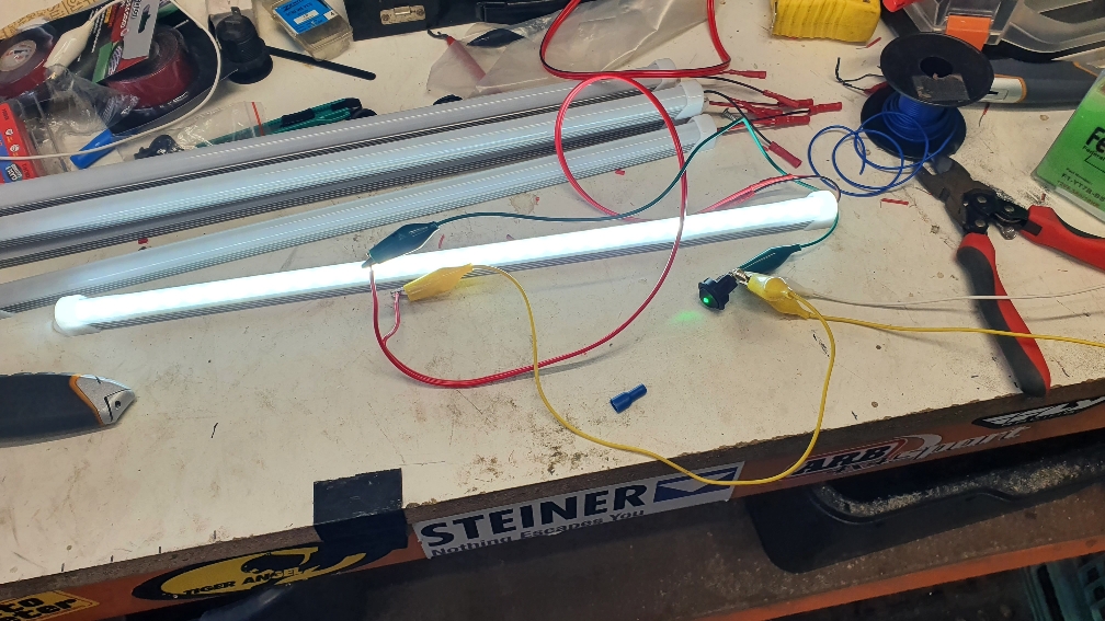

LEF strip lights off ebay defused and ready to mount 5 for $18! Cheap as chips.

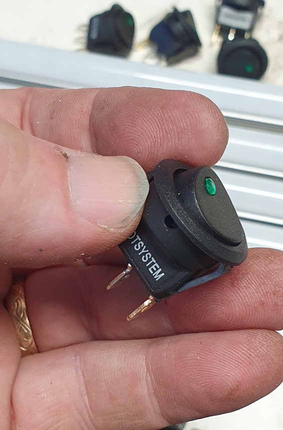

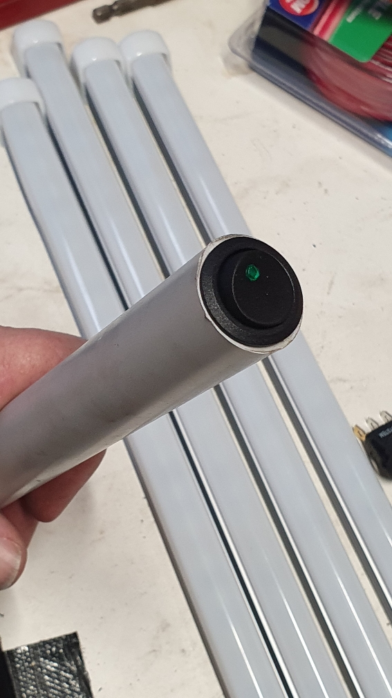

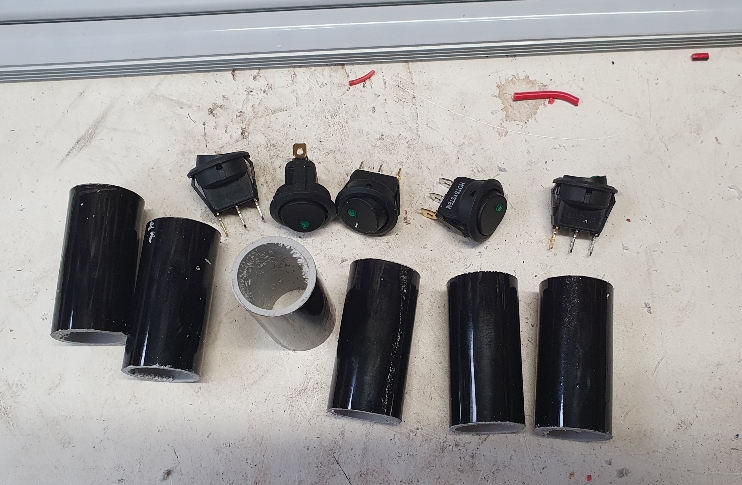

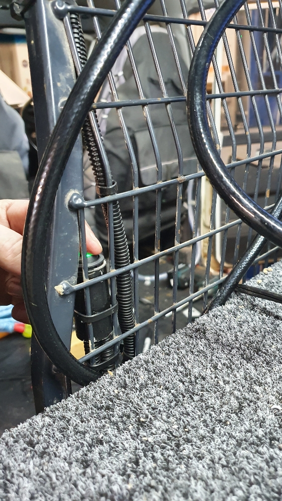

Had to figure out how I was going to mount these switches off ebay too. 19mm hole.
Inside diameter of 25mm conduit.......19mm!
http://www.nissanpatrol.com.au/forum...2021/03/33.jpg
Painted conduit yesterday. Cut 60mm tube on bandsaw today.

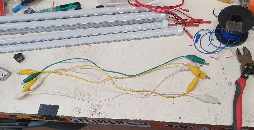

Sussed out how the 3 pole switches work by bench testing.
http://www.nissanpatrol.com.au/forum...2021/03/35.jpg
These are bloody handy for that. Jaycar. Cheap.

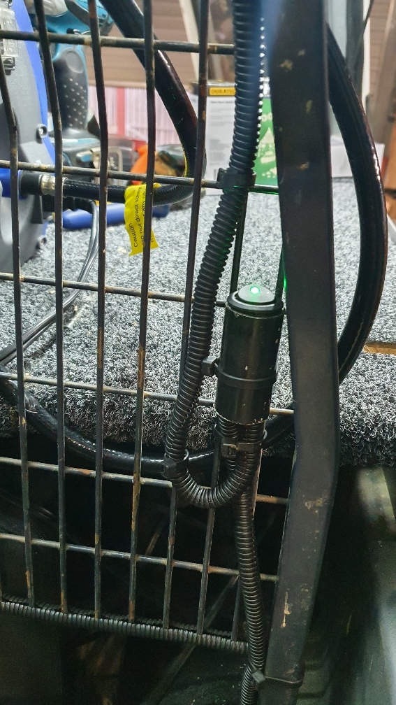

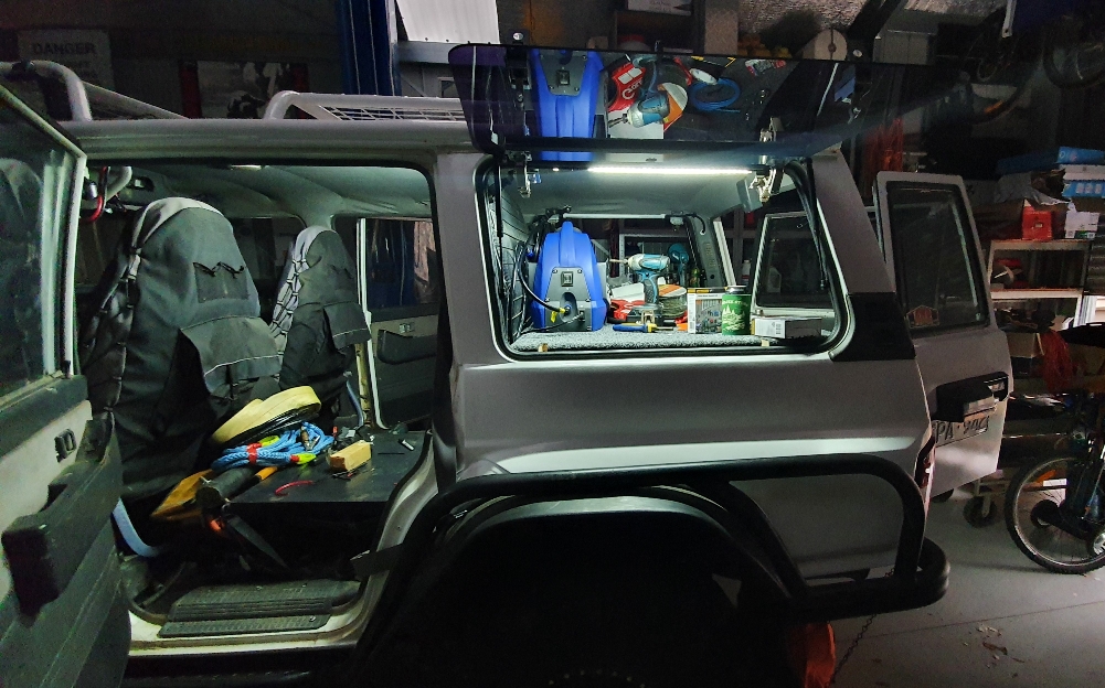

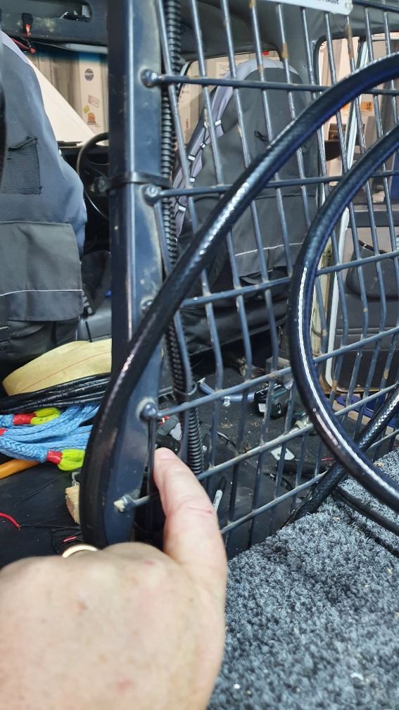

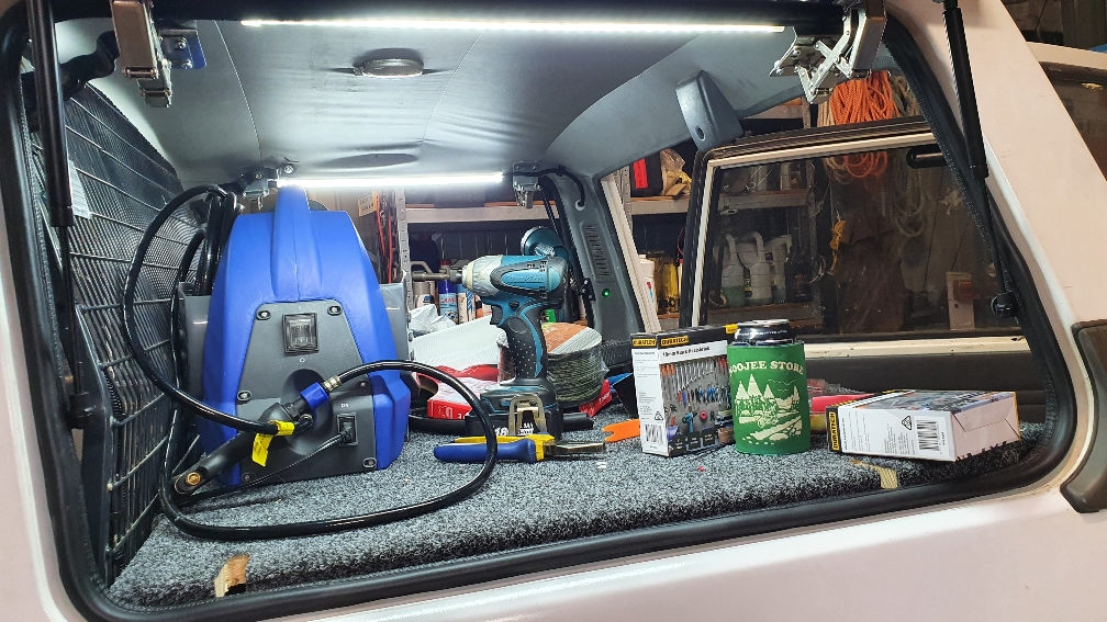

Spent a lot of time pulling wires and splicing looms but stoked with the final setup. Everything is fused off existing cicuits off my rear subboard. Very pleased.
http://www.nissanpatrol.com.au/forum...2021/03/37.jpg
How good is that. I can reach it from the DazWing side or the back seat side.
http://www.nissanpatrol.com.au/forum...2021/03/38.jpg
http://www.nissanpatrol.com.au/forum...2021/03/39.jpg

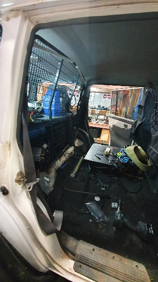

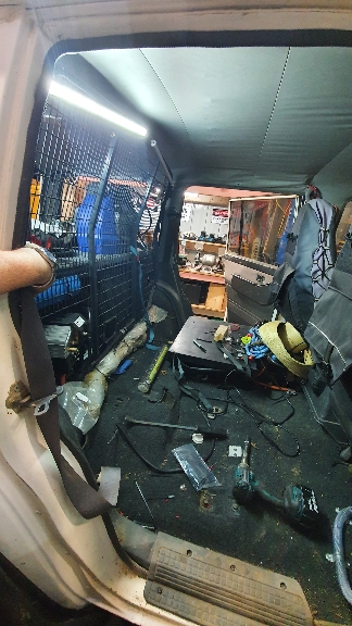

I ran a switch to each side switching a light to the back seat storage area. I pulled the back seat out for a Trip next week. So Good!!

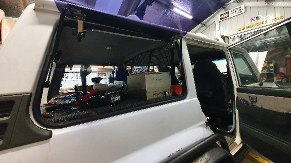

How good is this!! The DazWing is Sik. The switch for the DazWing light is on thr D Pillar so I can switch it on from the side or when at the back of the car.
