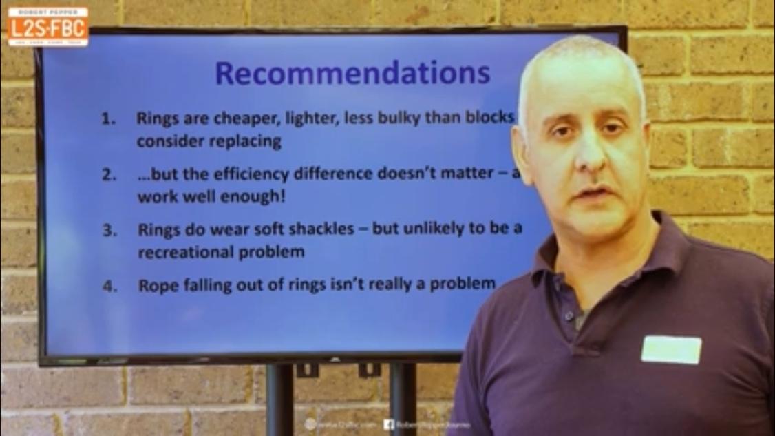

Here’s another interesting test from Robert Pepper on Snatch Blocks versus Rings:
https://youtu.be/rdlRRAbzCzA
Appears at the 20:00 mark that we should account for an approximate 5% efficiency loss for a Snatch Block & 10% efficiency loss for the Rings:
http://www.nissanpatrol.com.au/forum...021/02/157.jpg

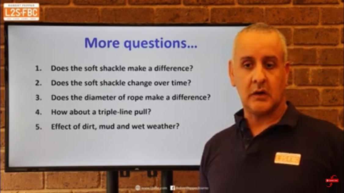

He’s going to do some more tests soon to see further affects of mud etc....
http://www.nissanpatrol.com.au/forum...021/02/158.jpg

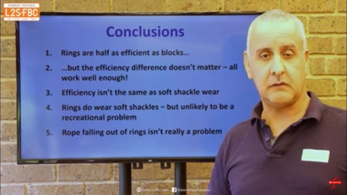

Efficiency variance seems to not be much of an issue to worry about in his opinion:
http://www.nissanpatrol.com.au/forum...021/02/159.jpg

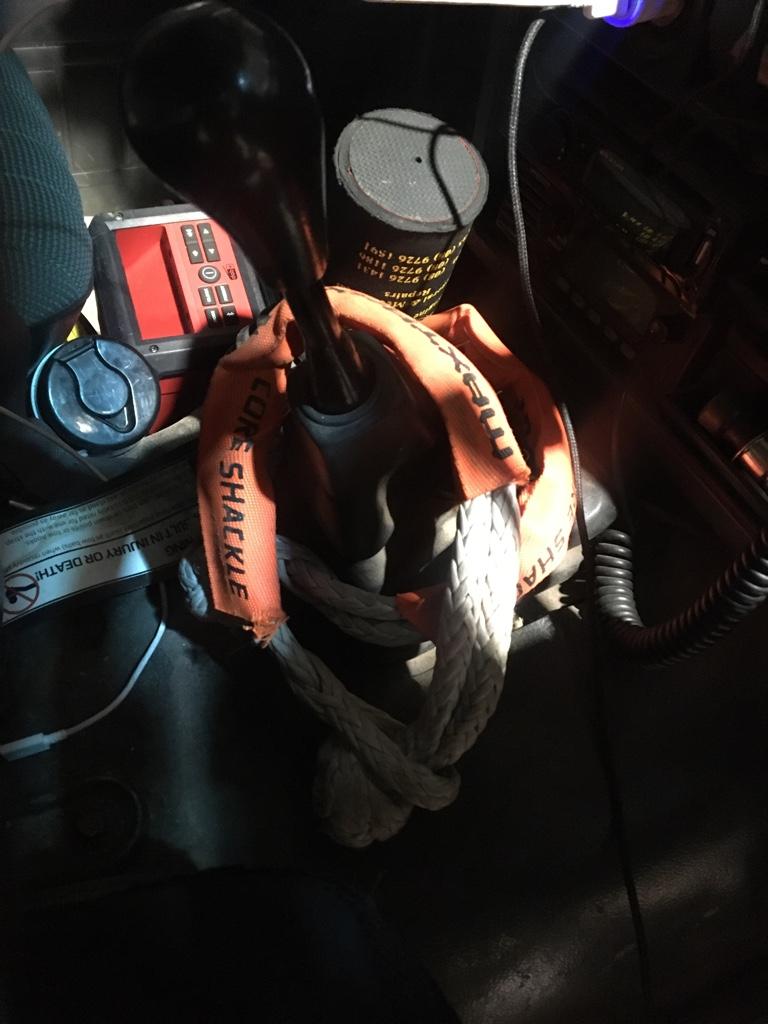

Bought em, couldn’t trust my own monkey fist knots some years ago I think, lightweight and stored conveniently out of the way [emoji123][emoji736]
http://www.nissanpatrol.com.au/forum...2022/07/27.jpg
Time wise, still have never utilised them?

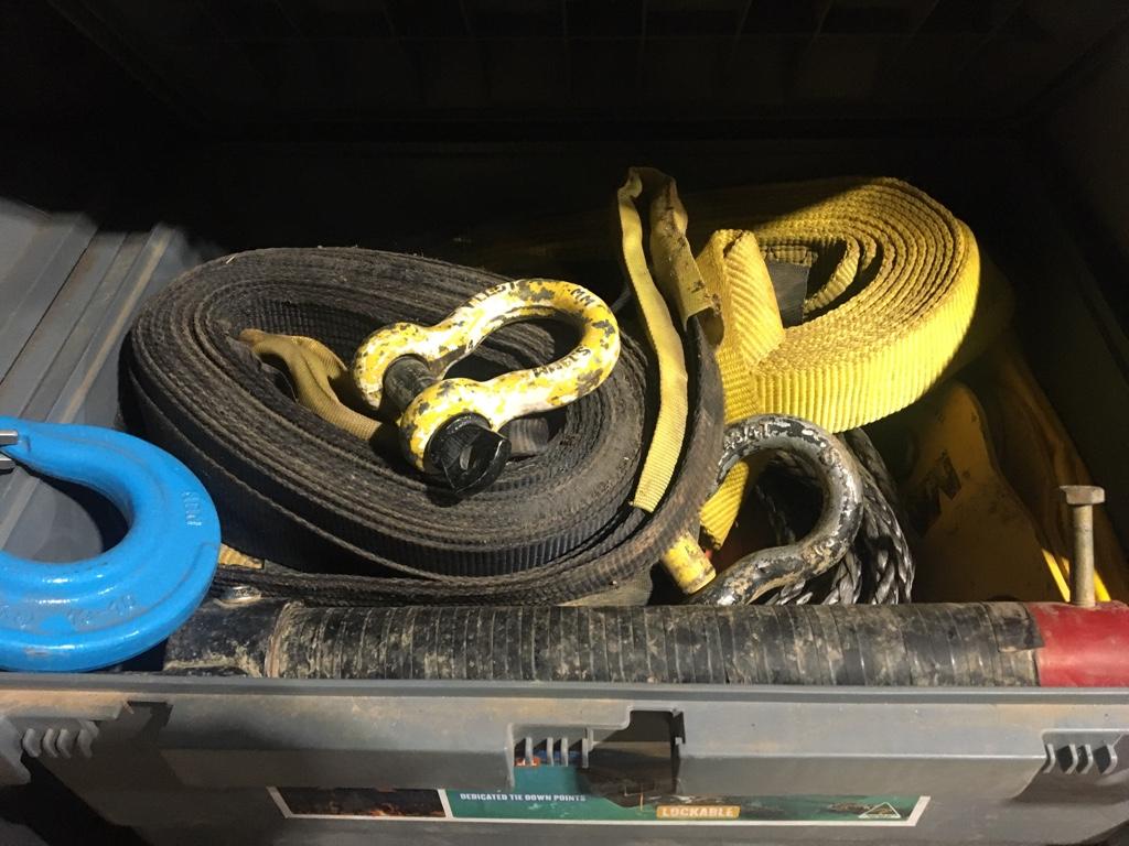

Every Landcrab we pass by has sharp recovery points requiring old school Bows ?
http://www.nissanpatrol.com.au/forum...2022/07/28.jpg
In all honesty, is it a nice to have connection but in reality Peoples trucks out there are non compatible? [emoji120]
They’re not in the way, will keep though for a rainy day [emoji848][emoji120][emoji120]
@MB nice one mate. Yeah I have quite a few soft shackles now. Still like the ones I made as the strongest I have as they are the only ones made from 12mm rope. Over the gear stick for the storage win for sure.

I’m confused Again Dazman [emoji120][emoji120]
As per above, where do I connect a soft bought shackle to the likes of any modern car with Aftermarket sharp as razors tow/recovery points? [emoji120][emoji120]
EDIT: Happy to RIP a Melbourne City sexy ‘D’ shackled colour coded bumper clean OFF its tinfoil chassis [emoji23]
