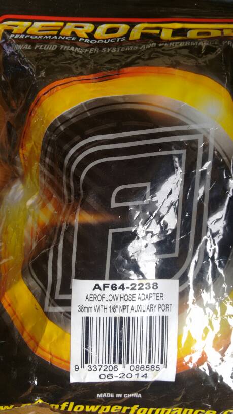

68 degrees celsius is as high as the temperature would go whether it's idling or driving on the road for about 15 minutes or so.
The aftermarket gauge is accurate as I tested it outside the vehicle today.
The gauge sensor location is T joint between LPG converter & the engine block.
