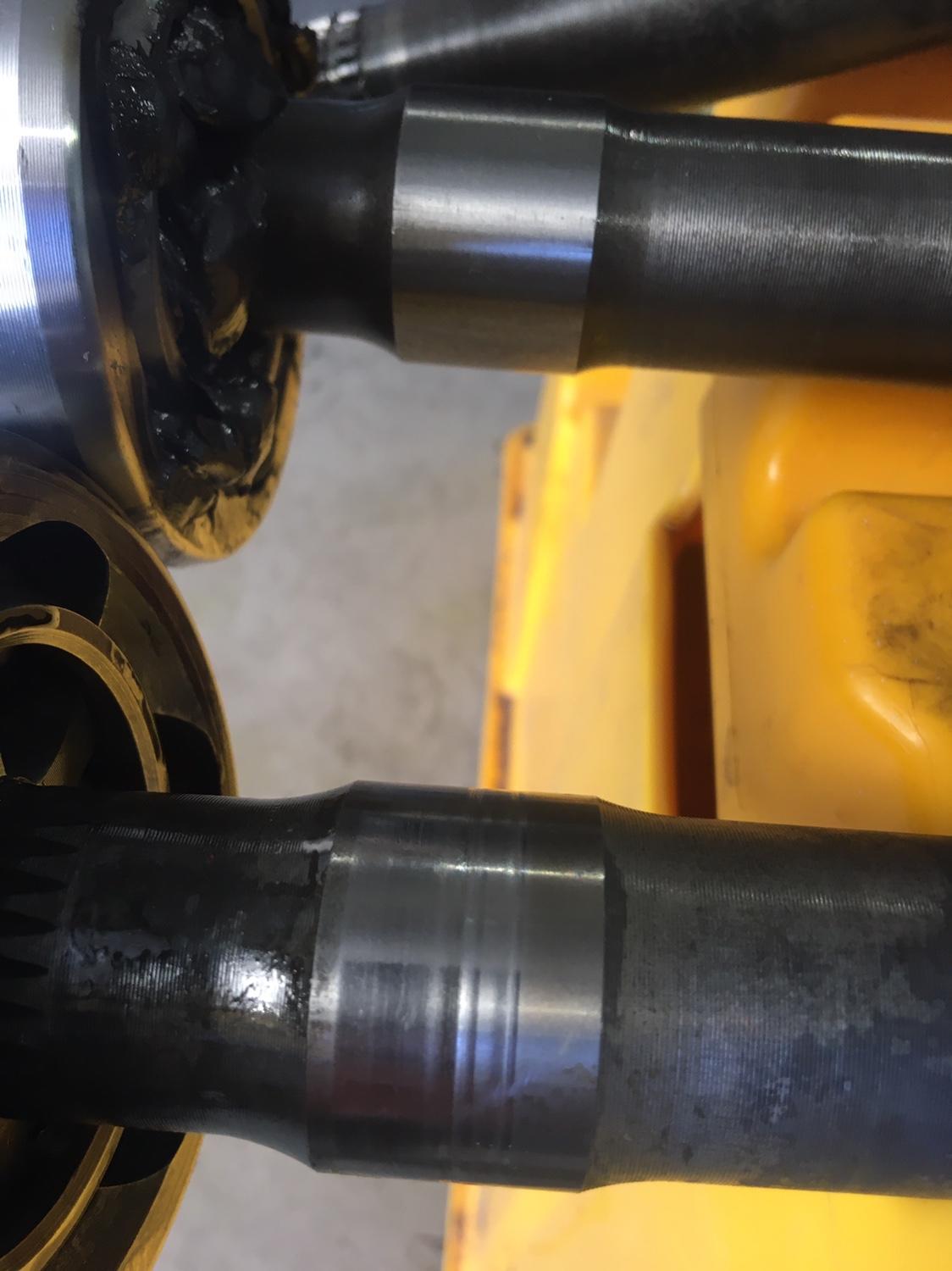

Installed new front CV/Axles in the 35 year old GQ Grandpa Spec ute. Wasn’t 100% happy with the full lock smoothness of CV rotation and some wear appearing on the inner seal axle region.
http://www.nissanpatrol.com.au/forum...2020/12/50.jpg
Usually stick with Nissan OEM parts but....... nearly $2,000 AUD for a set, bugger that!!
$169 per side from Patrolapart for ‘Roadsafe’ aftermarket brand will have to do [emoji23]
Keeping the old OEM ones onboard for spares if ever needed out there or if the aftermarket ones explode, hopefully not [emoji1696]
Cheers Mr Mark Mate!
Tis a fair dinkum mine field out there finding/trying to make sense of aftermarket quality versus OEM stupidly priced!
Cooling wise, I’m personally staying staunch on OEM and wherever else possible but near $2,000ish for front axles possibly not needed was ridiculous:-(
A serious thread on such pros [emoji739] cons for particular aftermarket parts with found unfortunate/fortunate findings experienced would be factually hopefully awesome [emoji106][emoji106]
