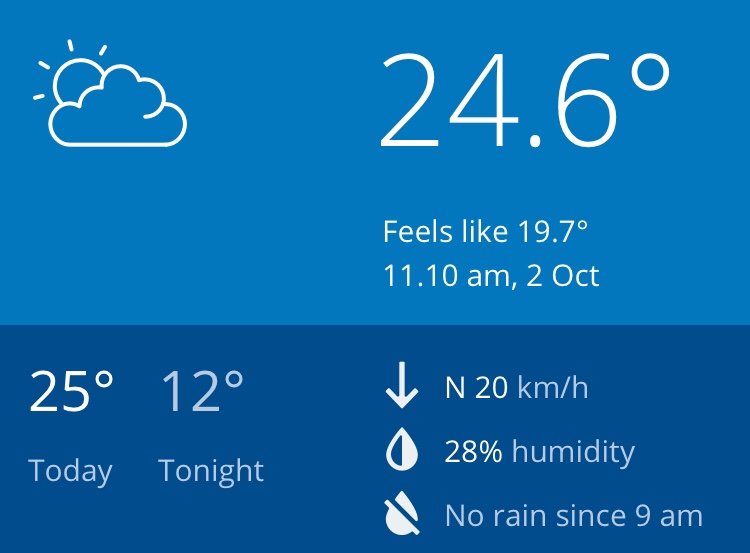

We just jumped across a few dozen hills onto the Western Ring Road for a 100kmph straight blast down to Werribee and back.
181km for 23.1L used (12.76L per 100km)
More or less water temps smack on 92C the whole way on the highway.
(100kmph @ 2,150rpm with 3.9 stock highway diffs powering 285/75r16 KM3 M/T’s @ 3,000kg GVM)
Really does appear that 92C is its “sweet spot” many thanks @nissannewby mate!
