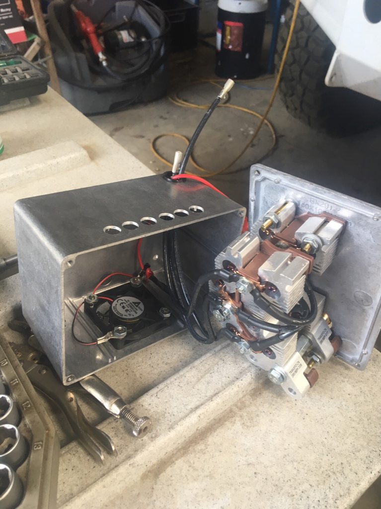

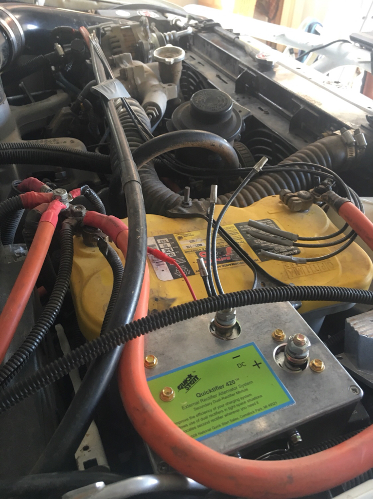

Installed a 'quick t verter' device to the charge circuit of the main alternator. Its a rectifier pack that splits the load across 18 diodes instead of the standard 6, hence allows for the rectifier diodes to individually run cooler and increases charge efficiency. What I have found since installing it is that the main battery voltage does not drop when on high beam, all driving lights on. Before installing it the voltage would gradually fall and the alternator could not keep up - is a small mitsubishi pajero 100amp unit installed by Brunswick Diesel as part of the Chev conversion. There is a bit of minor work to do to the alternator, but looks good. here is the link to the device. I and @MB have purchased the 420amp units. They don't boost the output, just decrease the load over more diodes. Both our Chevs run hot and alternator death has become the norm of late - hoping this fixes it.
https://alternatorparts.com/quicktif...rectifier.html

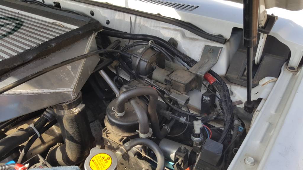

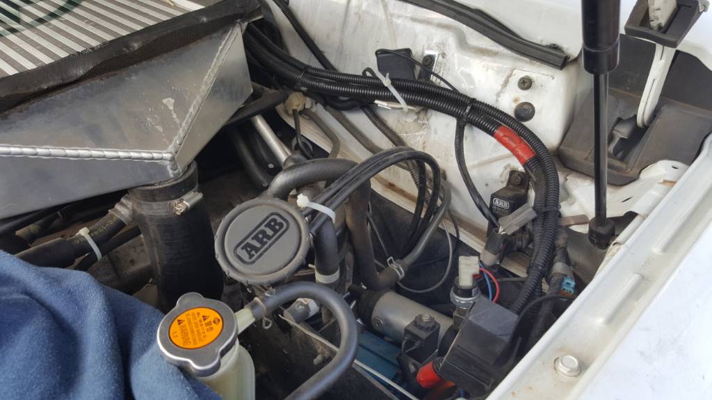

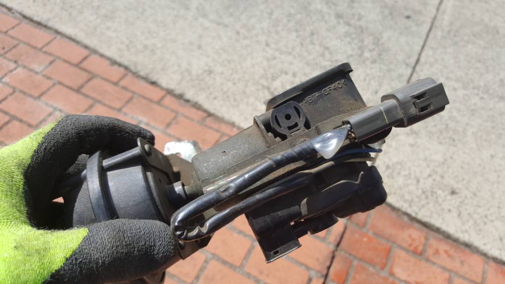

Just ripped out the cruise control vacuum/motor and the pull-cable all the way to the pump.
Gained ample room for the Catch can. Perfect spot.

Cheers again Philstar for kindly getting these Quicktifier jobbies in mate! http://www.nissanpatrol.com.au/forum...018/03/243.jpgI’m running a bit behind your efforts mate but managed this arvo to bolt the 170amp GQTD42 alt back in after its birthday with 3 x phase wires at the ready! http://www.nissanpatrol.com.au/forum...018/03/244.jpg Just needs final connections now and away we winch/fridges/lights/fans galore up and running again for now ;-) http://www.nissanpatrol.com.au/forum...018/03/245.jpg
