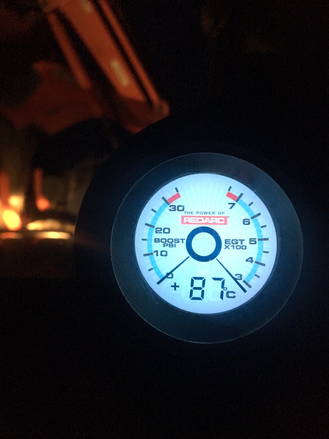

A/C fan on demisting/cooling engine bay at idle for 30mins seems to have come up to 87-89C ping pong compared to frigid nights prior pictured before at 82C.

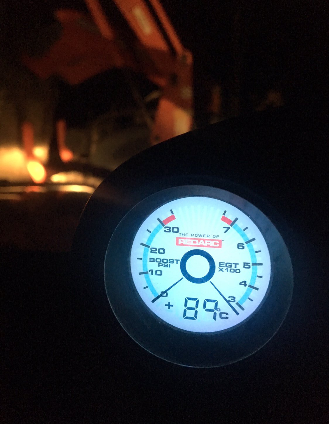

A/C fan off for a further 20mins and seems to ping pong between 88-89C.
