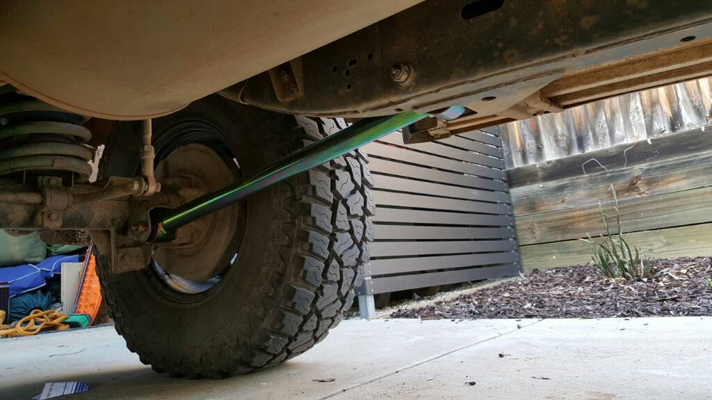

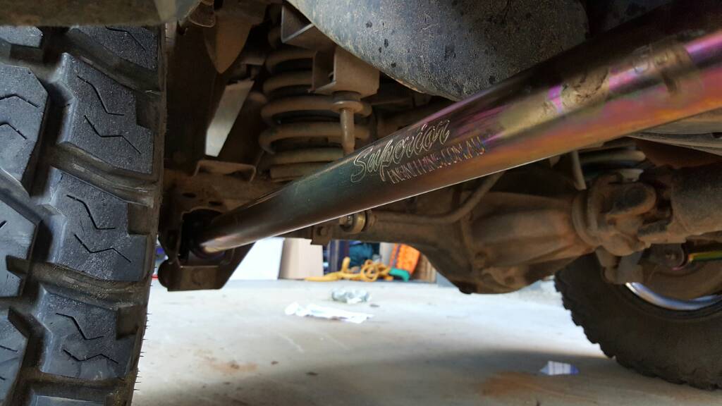

Replaced lower control arms with HD ones.
http://www.nissanpatrol.com.au/forum...016/05/240.jpghttp://www.nissanpatrol.com.au/forum...016/05/241.jpg
Tomorrow I'll replace the upper bushes, need to take the uppers out then drive to a mates dads workshop to use a press.
Anyone want some standard lower arms? In Bendigo, bushes actually look quite serviceable.
So got the passenger arm done and back in and also torqued up. All my parts turned up yesterday. So turned up a press tool for the panhard bushes and rear control arm bushes. Picked up the injector pump last night as well. All going well I will get that in tomorrow night. Also tonight I replaced front panhard bushes, replaced front sway bar links and bushes, inspected and adjusted front wheel bearings and swapped the wheels over to the factory alloys with the new 265/75/16 Nitto terra grapplers.
