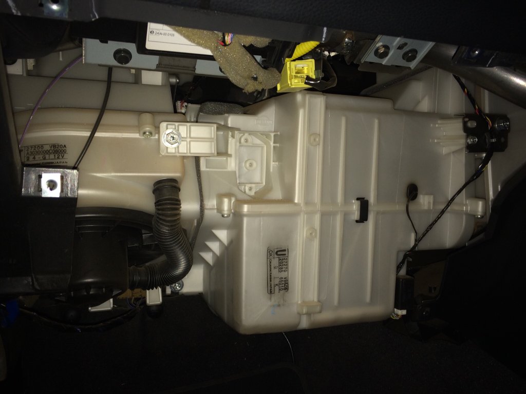

I'm a bit new to this pollen filter thing. How would Nissan replace it if you wanted them to do it? Would they have to cut bits out of the car? Seems a pretty poor design. Any info gratefully received.

http://www.nissanpatrol.com.au/forum...017/06/200.jpg
Did the mod the other day... very easy, 20mins max to cut slot and install. Have a 2012 GU.
Bought my filter kit from Supercheap Auto for $50, but notice there are cheaper ones on eBay. Will order one of those next time... just wanted option to return if it didn't fit.

Looking to do this on the weekend. From what perspective is this photo taken and what part is the filter kit? Lmao excuse the ignorance.
The rectangle section below yellow plug. Looks like it has two hole in it. Sorta. You cut this bit out and then slot the two panel filters in. The genuine kits come with a small metal clip to hold the two filters together. Not sure if the Ryco kit come with this clip though.
