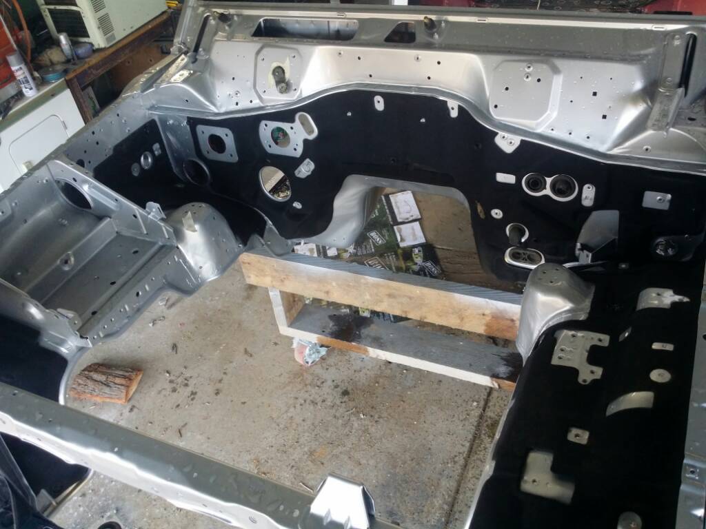

That sound deadening though!!! OMG! Slick Rossco.
Hey a 70mm foam Roller is your friend Next Time you paint the chassis. What prep did you do to the chassis and what paint?

[QUOTE=Rossco;733108]Yeah still not the one I remember, cheers anyway craig. Had a bit of a dig might have more of a look later. . .
Anyways finished painting chassis with brush, looks pretty smick.
A bit better cleaned out, should save a bit of weight. Put in some 15mm coil spacers all round too, so with the reduced body lift should be similar to what it was.

That just looks sexy as ..... unfortunately, it won't take long till it will never look this good again I reckon ....:harhar:
Yeah i know it's smick as.
Yeah roller's a good idea actually I'll definatly keep it in mind next time i paint the chassis. [emoji6] might make it a monthly routine. . .

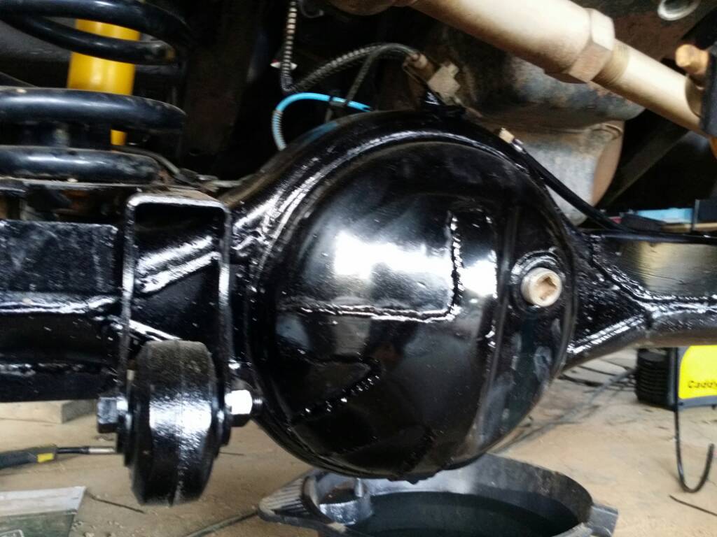

Just Karchered it, wire brushed bad bits and used prep wash with a rag everywhere i could get to. Just used motospray chassis black from super dodgey . . . Should see the rear diff too OMG it's to die for . . Just need to do the front one, plan was to put in the diff brace while the body was off but ran out of time, that's next on the list. .

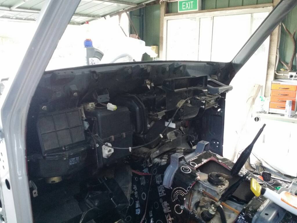

What your sort matting have you used on the floor of the cab there Rossco?
Hahaha monthly painting of the chassis 😝 , I'm about to strip my 'BIG' truck seats & floor out & line it all with dynamat but I'd heard of PingJing & now I've seen you've used it I might give it a go .

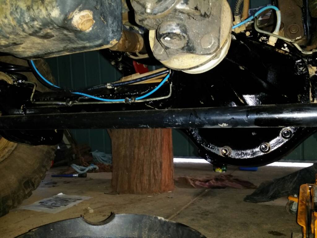

Finished the front diff yesterday, was a bit of a mission doing everything lying down upside down!

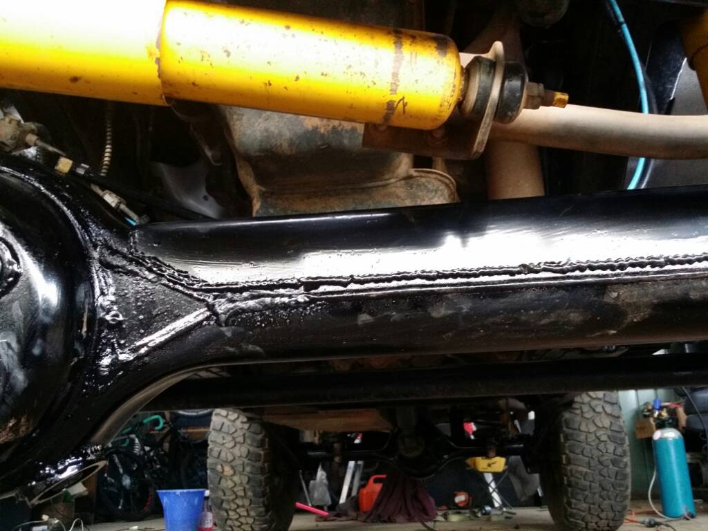

Laminated & braced using race bred kit, good stuff as always from them.
http://www.nissanpatrol.com.au/forum...017/07/136.jpg
http://www.nissanpatrol.com.au/forum...017/07/137.jpg

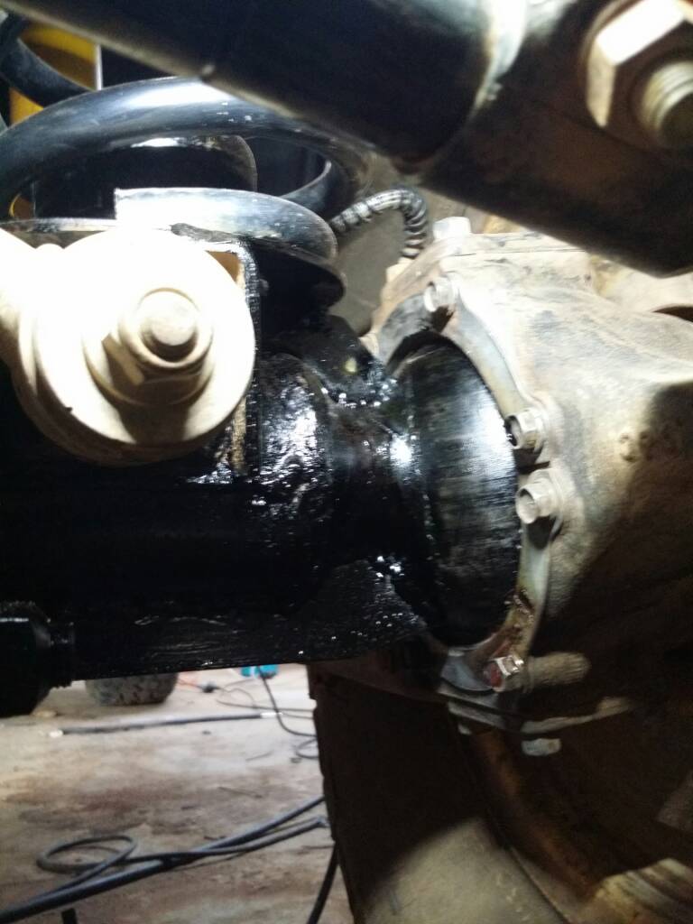

Also comes with gussets for the steering knuckles. Hope I didn't get to much heat into the axle seals and it starts leaking. Find out I guess. . .
