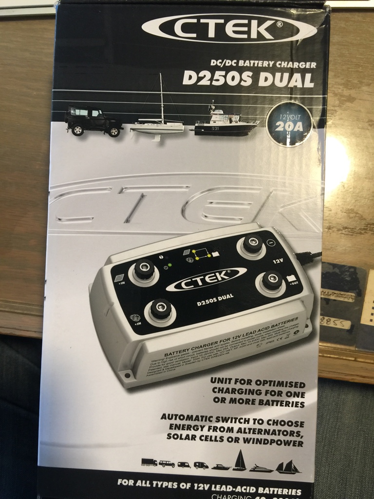

So I've listened to you guys and abandoned the idea of a DC/DC in the car. Don't fix what ain't broke. Like that logic.
After a fair bit of consideration I found the CTEK unit on sale on eBay at a good price so will fit it into the camper supplying 2 new 105AH AGM batteries (found some for $150 each on eBay! Score)

I did have a look at these too. I got the CTek for $265 delivered and couldn't go passed it to be honest.
But just having another look on eBay and this is a Bloody Good deal! If id seen this i may have gone this way as i need a couple of batteries anyway.

Just out of interest what is the float voltage of the Ctek Darren, & does it have Temperature compensation? If not it is on par with Redarc & Intervolt products. If it does then I would suggest it is first preference.
Just opened the box and had a read through the owners manual. its thick but is 8 languages.....
It has a Float Function but doesn't declare the voltage. It has a 1.8m long Temperature Sensor that i connect to the side of the battery and has Temp Compensation but doesn't declare at what temp.
