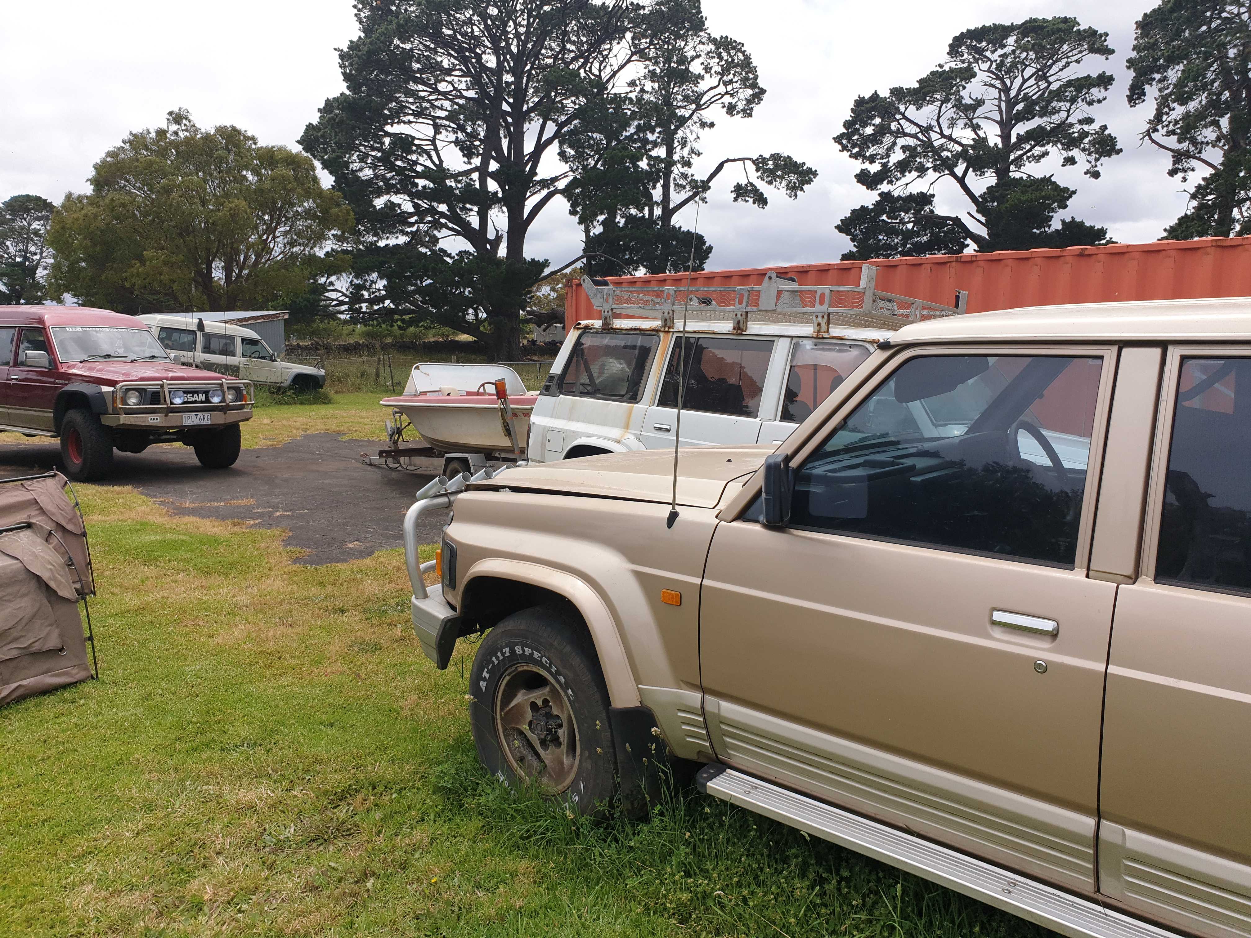

Thanks for that ! Have a little bit of work for myself now ! http://www.nissanpatrol.com.au/forum...2019/12/93.jpg
